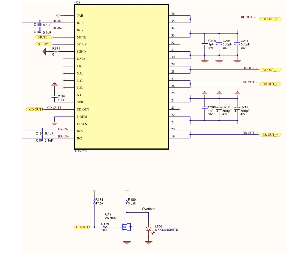

When TDA7577 disables I2C mode, how to clear the fault through hardware control and restore to normal operation state?
  • October 31, 2021
  • 0 replies
  • 733 views
