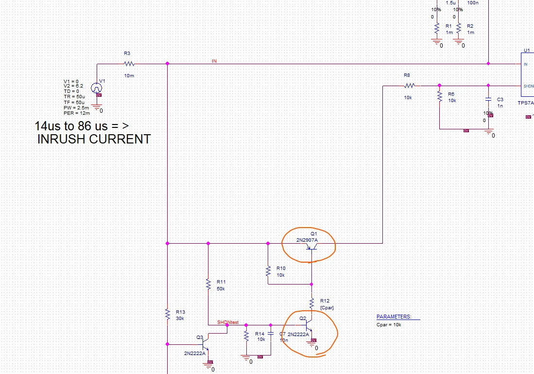

    I use 2N2907AHR as a switch e.g., the picture below. Where should I connect it?

    In terms of high frequency, it probably doesn't matter whether the lid is connected to GND or VCC as both are usually connected via some capacitance. In space applications it may depend on the radiation which connection is preferred.
