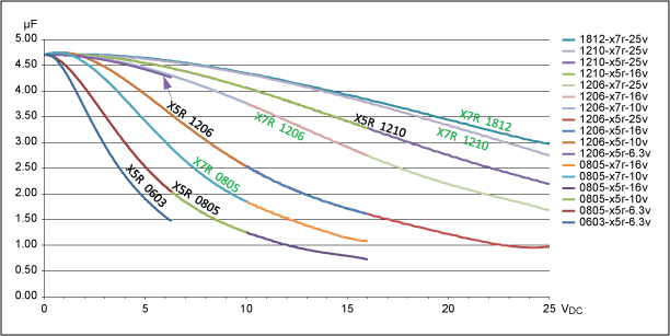

In short, capacitance is a function of voltage. At 0V, the capacitance is the rated value, but it drops as the capacitor becomes charged. This effect is stronger for smaller capacitor packages. This means that your sinusoidal input will not be symmetric, even with large caps, but the effect is stronger as you move to smaller sizes.
Here's a good graph that shows the effect along with the effect of smaller packages:
Using larger caps and/or ones with larger voltage ratings is one solution. Another would be to have your input be symmetric about V=0 and bias it afterwards.

For signal processing, use only NP0 / C0G ceramics (your only chance for small size), if possible with a voltage rating about 5 to 10 times higher than your expected peak-to-peak voltages.
So it's rather the ceramics type and voltage rating than package size (which are related).
Never use ceramics called "Y" something, use the "X" types (X7R, X5R) only for buffering DC voltages.
I'm using these for years now in low noise, low distortion audio circuits.
