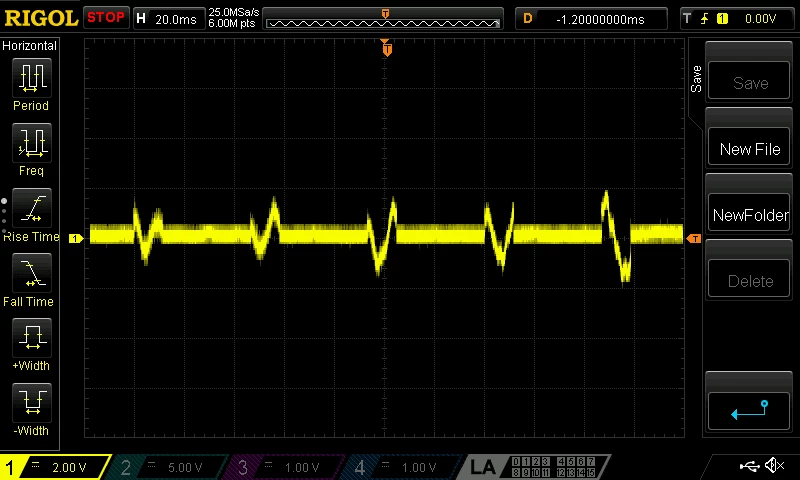

Sound is deformed and too slow.

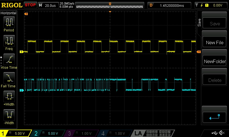

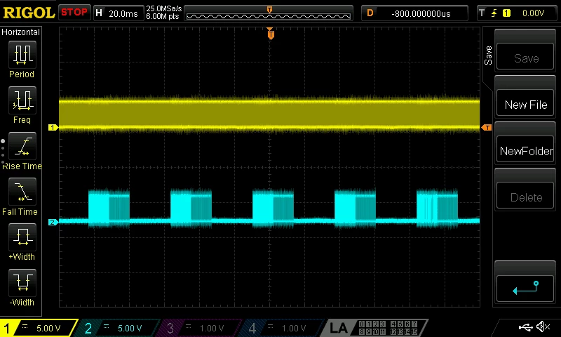

When I connect oscilloscope I can see that audio signal is generated only in 1/3 time.
_legacyfs_online_stmicro_images_0693W00000bj3nJQAQ.pngWhen I checked LRCK i SDATA signals - reason is clear.
_legacyfs_online_stmicro_images_0693W00000bj3nTQAQ.pngBelow you can see the most important code:

What can be the reason of this I2S behavior?

    Tesla DeLorean
    Guru
    April 29, 2023
    I'd probably opt for a larger buffer, and align the data reads
    The header read will knock it out of alignment, so perhaps you can just zero it out, or figuring out a different buffering scheme.
    Benchmark the reads, make sure you have the bandwidth.
    Check I2S with a sinewave you generate.
    MLemb.2
    MLemb.2AuthorBest answer
    May 1, 2023
    Thank you for suggesions. Debugging with sinewave was helpfull :)
    Finally I founded 2 problems:
    1) I have int16_t type buffer (2 bytes), but function f_read need amount of data to read in bytes. When I sended AUDIO_BUFFER_SIZE / 2 it read only 1/4 buffer. I change it to AUDIO_BUFFER_SIZE to fill half buffer.
    2) I change sampling frequency of file and I2S configuration to 22kHz.
    After that sound is playing without deforming and at the right speed.
