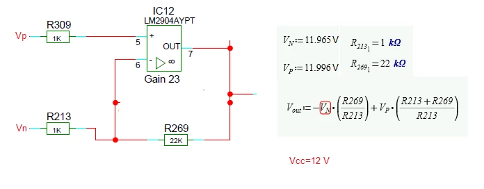

Simulation output voltage of LM26904A IC in LTSPICE
  • April 12, 2019
  • 1 reply
  • 1080 views
I have simulated the spice model of LM2904 in LTSPICE for the input voltages as shown in figure , as per the theoretical calculation output voltage will saturate to supply voltage VCC=12 V , but from simulation results output voltage getting 10.7 Volts.
Kindly suggest me the solution for the same ASAP0690X000008ASFTQA4.png .

as mentioned in datasheet the output voltage swing from 0V to (Vcc+) - 1.5V).
