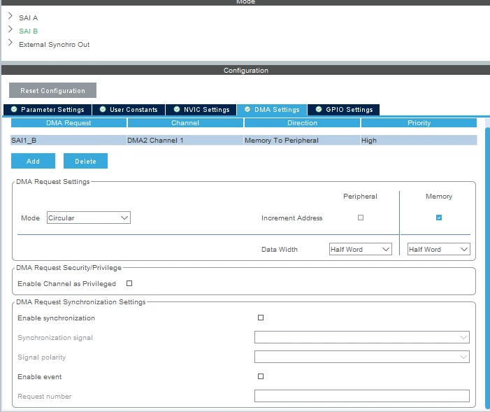

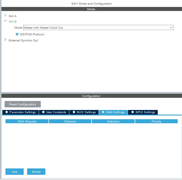

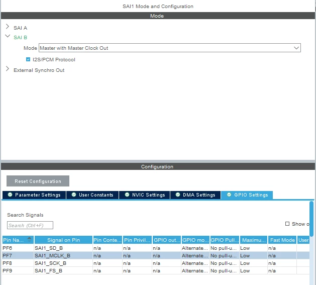

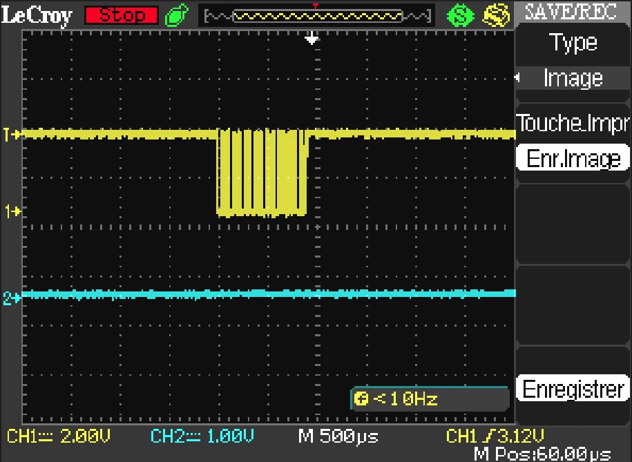

I would like to know if there are people who have already configured the SAI PORT to communicate with a CODEC ?
I configured like this :
But I don't have the clock on the PIN PF7 :
The SAI_MCLK_B is the curve in blue. Thank you for your helps.
Regards.

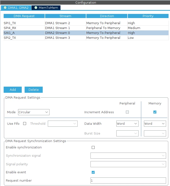

AScha.3
AScha.3Best answer
July 24, 2023
clock...dont know. but without continuous stream anyway useless...the dac will not work.
so use dma channel ->

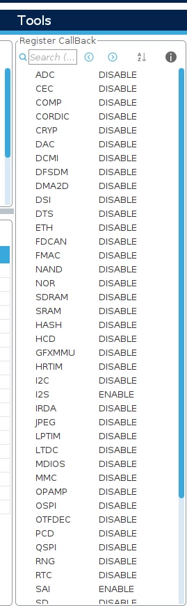

enable callbacks in project-> advanced settings
in main : register callbacks
then start it
init buffer, size should match, what you expect in update interval; i use 32bit data ymmv.
int32_t playbuf[4096*2] __attribute__ ((aligned (32)));
and for begin, switch off d-cache, if your cpu has it. (cache management ...for later. :) )
in callbacks put your data, or for "pause" , set data zero. but never stop the running stream !

DYann.1
DYann.1Author
Senior II
July 24, 2023

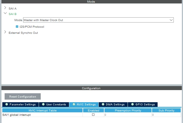

I'm working SAI with another CODEC (SGTL5000) but the principle is the same for the SAI. First, I sent data to configure the CODEC via the I2C bus, that you can see in my previous screenshot (the yellow curve) but I haven't nothing on the PIN 'SAI_MCLK_B'.
I don't know if it is necessary to work in interruption, after your answer I have to work in DMA but how ?
How to configure the settings? Do we leave it as default ?
why in mode without DMA we do not see the clock ?

DYann.1
DYann.1Author
Senior II
July 24, 2023

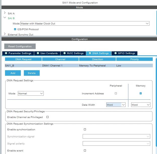

I tried with this configuration but there are too many errors in this code
24 errors
Now I have no more errors these are priorities

I don't know where is the 'DCACHE' but now I have a clock on the MCLK pin and I have no errors on my I2C bus.
Before I have an error in this function. Thank you for your helps AScha.3.
