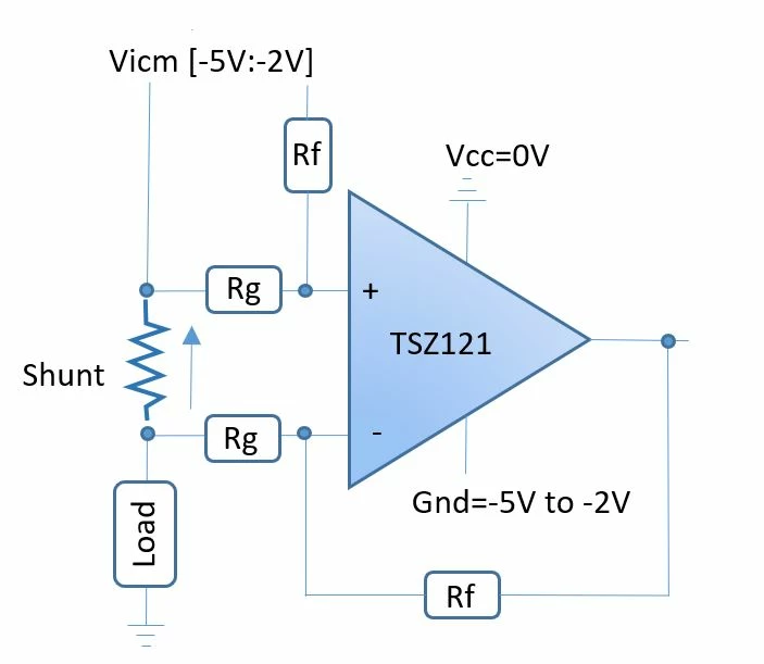

    ​Hello
    We can firstly have a look on two different way to measure a current with a negative common mode voltage.
    The simpler is to use a current sensing with an integrated gain able to work in this manner. It can be our TSC2012 product which accept a Vicm until -20V. It has a gain of 100 which is recommended to measure small current.
    In order to go deeper in the analysis, it would necessary to have more information about your application as the power supply , the shunt value you have selected and also the precison you are expecting on the output of the current sensing (especially for the lowest current to sense 100nA).
    The second option is to use a precise Opamp as the TSZ121. But the convenience with this option is a classical opamp cannot accept a negative Vicm. To use it in such condition you have to power your opamp with neagtive supply as well.
    For example put -5V on the GND pin and 0V on Vcc pin. In this manner your opamp is powered in 5V and can accept the Vicm=-5V. But take care the ouptut of your opamp will in the range of [-5V and 0V]. Is your ADC can accept such Voltage range? Otherwise you can have a look to the application note in attachement.
    A last option, if possible, is to sense the current in low side (between the load and the Ground).
    In this case you are not anymore constraint by a negative Vicm, as this one become Gnd.
    And you can use an Opamp as the TSZ121 powered with a 5V for example, or if you need an integrated gain for more integration and precision you can also think about the TSC212 current sensing.
    Please let me know which of this 3 options seem more suitable for you, or if something is not clear , and give me more details about your application to go in a deeper analysis.

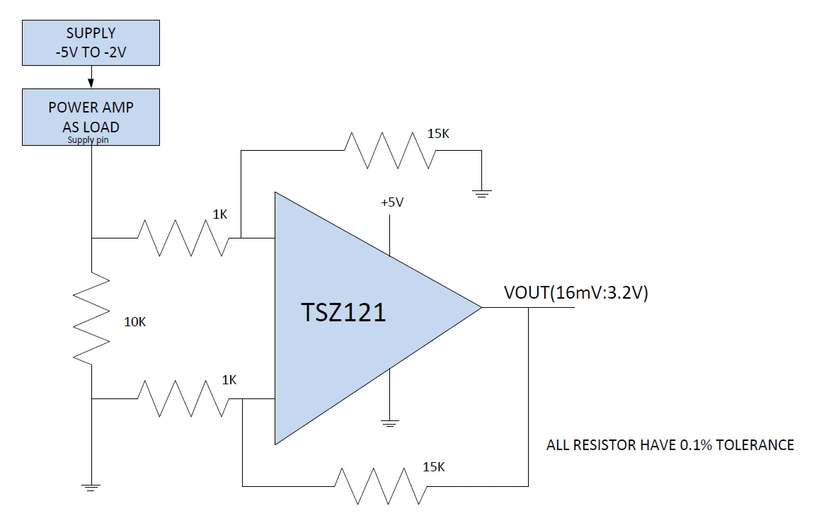

    NJani.2
    NJani.2Author
    Jun 2, 2021 9:18 AM UTC
    I think there is some misunderstanding.
    Kindly find attached herewith diagram what we have assumed for current sense implementation.
    Yes may be low side current sense is not possible in our application but we want to confirm from your side.
    precision required is 1% or 5%.
    ADC input voltage range is 0 to 3.3 V , so we are planning to use voltage divider at the output of op-amp to shift the negative voltage to ADC input voltage range.
    Please guide.

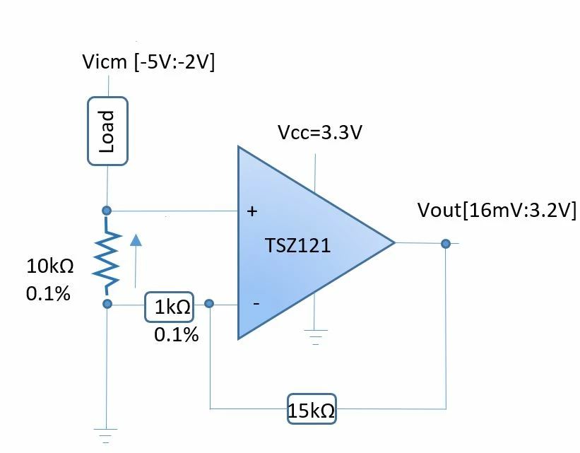

    AUPETIT nicolas
    Visitor II
    Jun 2, 2021 4:10 PM UTC
    Thanks for the clarification
    Nevertheless let me still clarify this point:
    A low side configuration is the simplest configuration as you can directly address the ADC, and the best one in term of precision,
    Just let me propose a low side configuration with a first order approach of expected error, and let me know if it possible for you to implement it
    With a shunt of 10kohms, the voltage to amplify will be in the range of 1mV to 200mV. With a gain of 16 the theoretical output will be in the range of 16mV to 3.2V
    In the attached schematic, the Vicm is fixed to GND, so there is no variation of the input offset due to Vicm variation
    Thanks to low side configuration, the CMRR due to the external resistance is null.
    To simplify let consider only the input offset voltage and the resistance precision.
    The resistances (gain and shunt) have a precision of 0.1%, so a gain error of 02% can be expected + 0.1% of shunt precision, so the external resistance add 0.3% error.
    Then considering only the Vio of 8µV (maximum over temperature) for the lowest current (100nA) it add in worst condition 0.8% error.
    So at first order 1.1% of error can be expected for the lowest current to measure.
    One of the main draw back of a low side configuration that it is difficult to detect a short cut to the ground.
    So just tell if this kind of implantation can be suitable for your application or not. Then we can go deeper in the analysis, or only consider high side configuration as previous schematic with an Opamp able to work with 10V power supply.

    NJani.2
    NJani.2Author
    Jun 4, 2021 4:41 AM UTC
    Thank your detailed guiddance.
    As per our understanding we want to use high side because my power amplifier(LOAD) is getting directly connected with ground with that configuration. if we go for the low side, then the power amplifier( load) will get indirect ground via shunt resistor of 10K ohm, which may cause any damage to load.
    If you confirm, that low side configuration and indirect grounding to load is not an issue, then we are good to go with low side configuration.
    If not , then we need to go with high side.
    Please confirm.

    AUPETIT nicolas
    Visitor II
    Jun 7, 2021 11:27 AM UTC
    Hello
    The shunt connected between load and ground can have an impact , if there is large current spike, that may perturbate the GND.
    Note that the same thing can happen with High side configuration, large current spike will impact the supply of the power amplifier.
    Anyway please have a look on the attached document, which described a high side configuration, and maximum error that can be expected on output.
    it is a worst case calculus considering max value and max temp.
    In this configuration, it is used a 16V amplifier powered between -5V and +5V. The most precise amplifier available in our portfolio, is the TSX711A.
    https://www.st.com/en/amplifiers-and-comparators/tsx711.html
    As you can see on the attached document due to its Vio=350µV max over temperature, and keeping a shunt of 10kohms the accuracy of 1% or even 5%, cannot be achieved for the lowest current (100nA).
    You can increase for sure the shunt resistance value (and so decrease the gain) , but the next issue will be the voltage drop into the shunt. It will become higher and then affect the power supply of the power amplifier. Power dissipation will also increase.
    On top of that due to the high side configuration, the external resistance (use for the gain), will add an error (CMRRes) principally when the power supply or Vp will be at -2V. In this calculus 0.1% resistance precision have been used.
    So to achieve the precision you need, the best solution is low side current sensing approach by using the TSZ121.

    NJani.2
    NJani.2Author
    Jun 11, 2021 6:47 AM UTC
    Thank you so much for your valuable support.
    We have gone through the details given from your side and come to a conclusion to TSZ121 low side configuration may be the best suitable to our requirement. as in high side, there is a chance of error as per given in your PPT.
    Please find below diagram and verify whether it is ok or not? or any further modification and suggestion is required.
    Once you confirm, we will finalize this op-amp.
    Once again, Thanks for your guidance .
    AUPETIT nicolas
    AUPETIT nicolasBest answer
    Visitor II
    Jun 11, 2021 12:04 PM UTC
    ​Hello
    A last point to check. It is the current sense you have to measure. As the lowest potentential is the power supply -5V, the current should flow from ground to power supply isn't it? So in this case, connection should be like this:
    If you need to use the current sensing  only in monodirectionnal mode, and so don't need the Vref on the schematic above, you can even save two resistances as depicted by the below picture.
    Precision will be even better with 2 resistances rather than 4 resistances ( as error is mainly due to the mismatch of the resistance)
    BR
    NJani.2
    NJani.2Author
    Jun 15, 2021 10:15 AM UTC
    Hi Nicolas,
    Thank you so much for providing valuable support to select best OPAMP for our project.
    Yes current flow from ground to power supply. As per your suggestion we will use 2 resistor 1K and 15K with feedback in low side configuration.
    Kindly suggest if any other things need to add or verify.
    once again thank you for your support.
    Thanks
