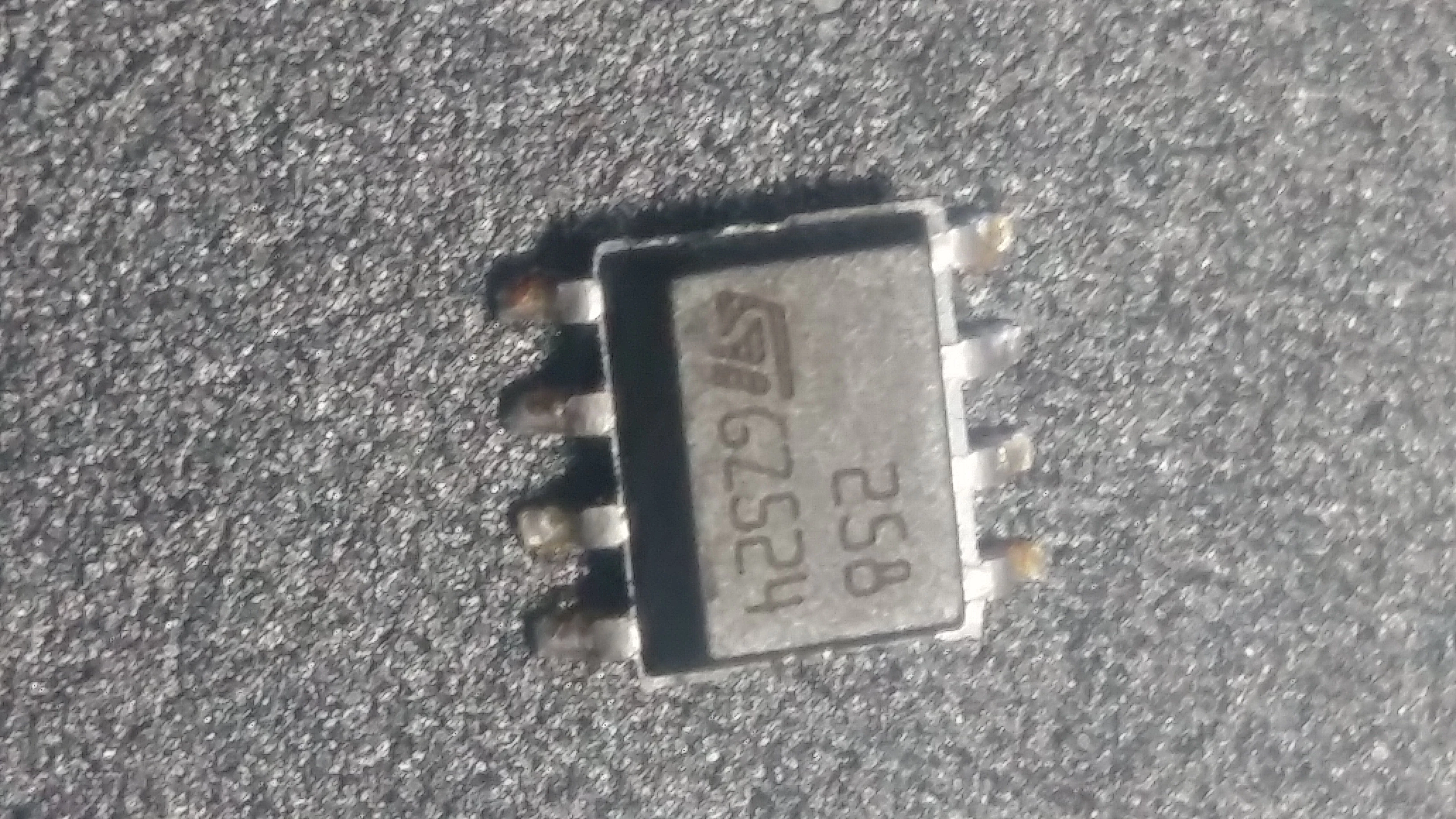

I am trying to find ST micro part from marking code given on it. - First line: 258 Second line: G(6?)Z524 Can someone help me to recognize right part number?

    Dear,
    This is a ​LM258 op amp.
    See : https://www.st.com/resource/en/datasheet/lm158.pdf
