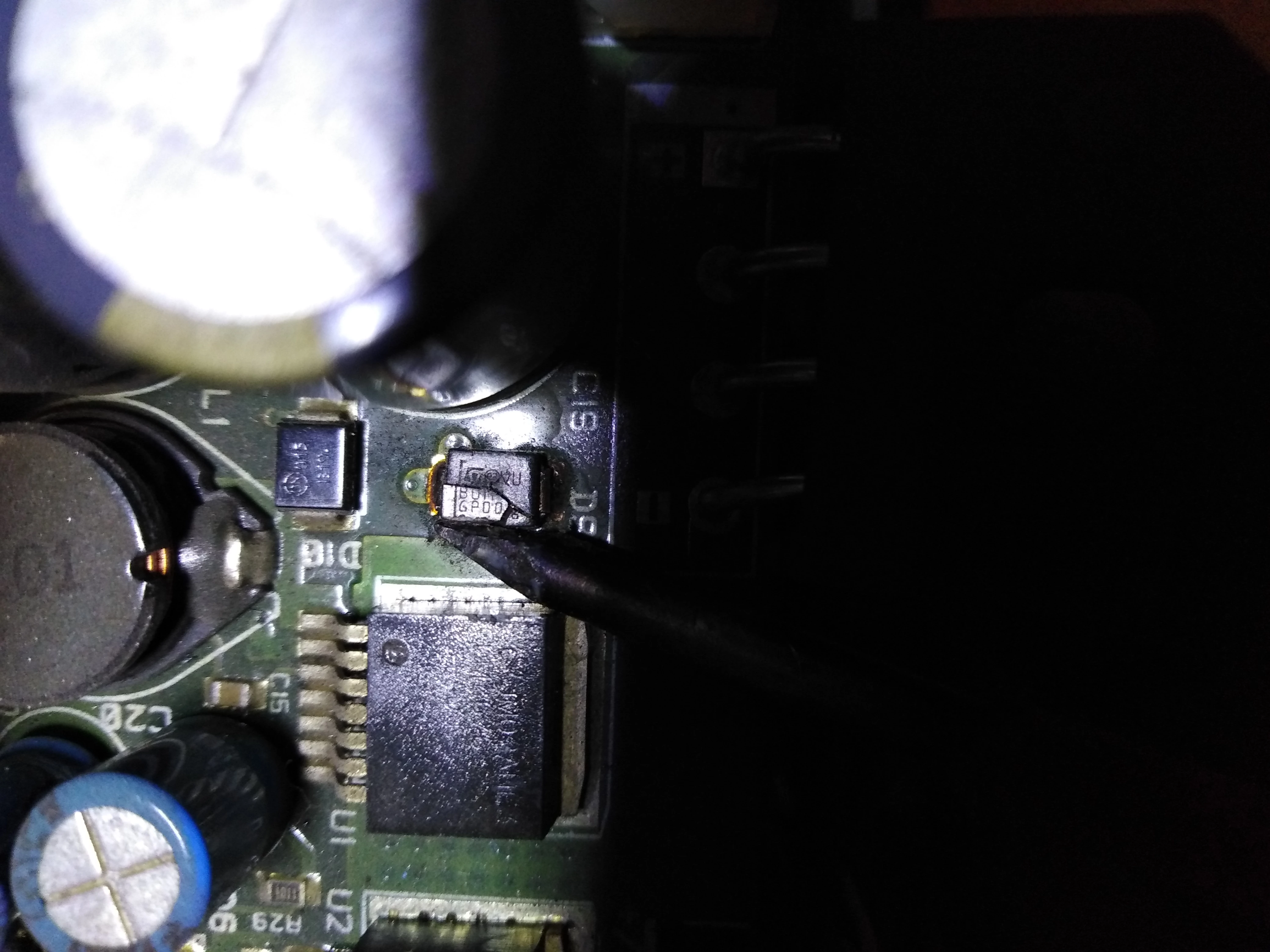

good evening kindly ask I have this your broken diode , but I do not know recognize the code politely ask for help. Thank you

    What is the number on the IC U1 ? That will probably give a link to the datasheet and what diode to use.

    Good day Mr, the uc1 is LM 2676. Thanchk

    It will be something like this
    https://uk.rs-online.com/web/p/rectifier-diodes-schottky-diodes/1513127/
    Any 50V 3Amp or greater Schottky diode should work so see what your local supplier stocks.
    Bigger question is why did the existing one blow up.
