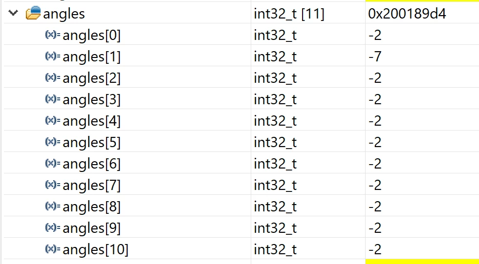

Hello, I cannot get SoundSL working to detect the source of a sound direction correctly. To check how the library performs itself, I wrote a little test script.
I assume a 1kHz sine wave to be sampled by a simulated microphone. At a sampling rate of 16kHz, the buffer for 1ms duration consists of 16 samples (per channel) that describe an entire period. At a sound speed of 350m/s and a distance of 0.1m between the microphones, the phase shift should not exceed approximately +/- 90 degrees (+/- 285us). According to my understanding, a phaseshift of [-90 degrees phase shift; 90 degrees phase shift] should result in about [-90 degree angle; 90 degrees angle] where in-phase would be 0 degrees (same distance to both microphones).
In the test script, I compute the sine wave values for a particular offset and feed the values to the library until the result can be calculated. Once one angle is gathered, I increase the phase shift and redo the whole process. The angles are then stored in an array. The results for a phase shift of [0 degrees; 90 degrees] with a 10 degrees increment are shown in the table. The results are not as expected. What am I doing wrong? I use library version 2.2.0.
Thank you.
Solved! I found out that the variable holding the simulated microphone samples was 32-bit instead of 16-bit.
