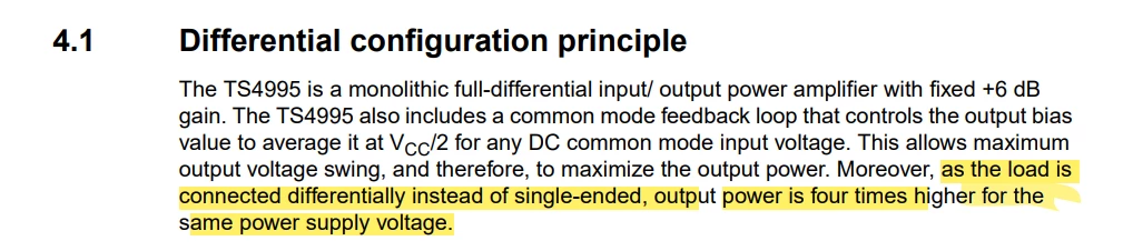

    there are currently three such amplifiers with 1-1.2W output power, which differ only in a few fine details, e.g. the housing and a few parameters:
    In principle, the differential output of such an amplifier can also be operated single-ended by connecting the load to only one output and to GND, but then the maximum output power drops to a quarter. Ultimately, such a differential amplifier does not work much differently than a bridge output stage.

    1.you explained me about the problem when connecting single ended loads to a Differential output amplifier but i need to connect single ended load, and also it should work for the differential loads also do you have any suggestion like adding any external IC for achieving this requirement.
    2.Your mentioned parts only explaining about the single ended input config vs differential input topology i didn't get any info about the single ended outputs, and in my requirement i need the output voltage at 12Volts but shared parts are satisfying the power requirement

    No at a time one load only i will connect but in your answer and shared part numbers i didn't get the info regarding how to get single ended output , only given like below
    Peter BENSCH
    April 6, 2022
    This is not mentioned in the datasheet, as it dramatically reduces the output power and also is not a common requirement.
    Anyway, you mentioned the requirement of 12V output voltage, which cannot achieved using these devices. In this case ST cannot provide any solution for you.
