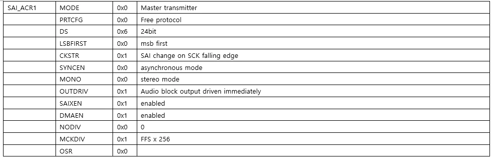

I'm implementing 24bit, 44.1kHz audio out code using STM32H7B3-discovery.
In previous question, i set SAI(I2S format) buffer like below.
0693W00000LyztVQAR.pngI set SAI_A block to output.
And, this is my SAI_A setting.
0693W00000LyzuiQAB.png0693W00000LyzusQAB.png0693W00000Lyzv2QAB.png0693W00000Lyzv7QAB.png​

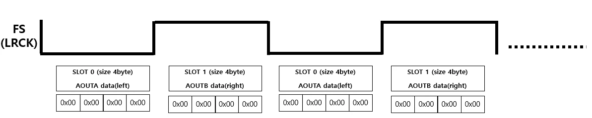

I set tx buffer to zero and BufferOutCtl.buff also filled zero.

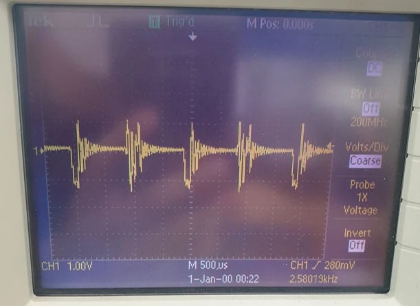

This is my output waveform.
0693W00000LyzvMQAR.png​
I thought that if I filled the buffer with 4 bytes of data and sent it to dma, it would be as below.0693W00000Lyzw5QAB.pngBut, I got noise waveform.
I checked clock.​
  • LRCK : 44.1kHz
  • MCLK : 11.29MHz

    YounjunBest answer
    Apr 26, 2022 9:05 AM UTC
    The problem has been resolved.
    I missed below code.
    HAL_SAI_Receive_DMA(&haudio_in_sai, (uint8_t*) pBuf, (uint16_t) (NbrOfBytes / (Audio_In_Ctx[Instance].BitsPerSample / 8U)))
    ​My Audio_in_Ctx[Instance].BitPerSample was 24.
    I modified this value to 32.
