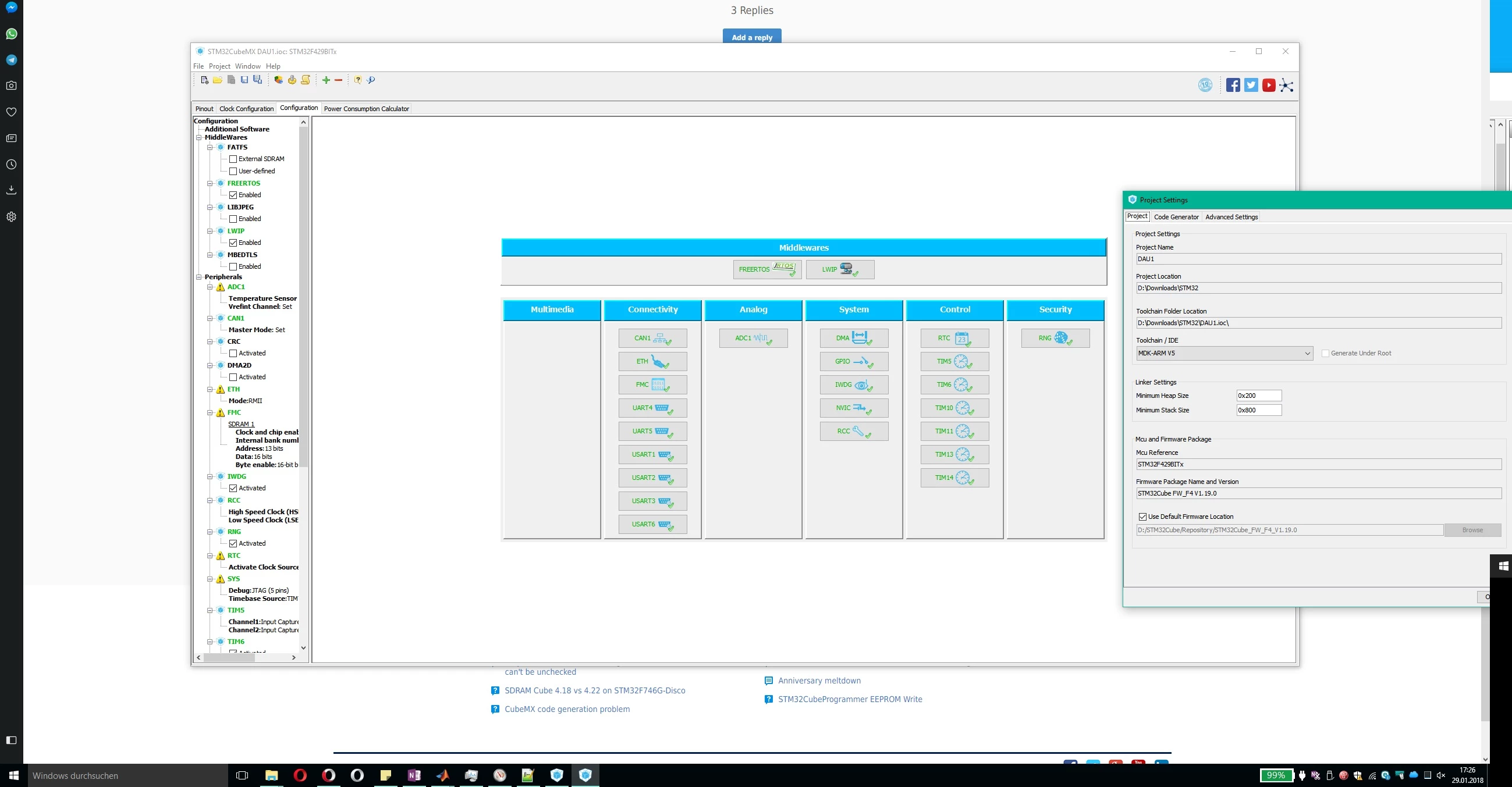

CubeMX 4.24 migrate problem
Posted on January 25, 2018 at 05:11
OS: Win10
ico version : 4.23 / FW_F4 V1.18.0
I can't migrate my project from 4.23 to 4.24. Attach is my ico file.
Thank you.

    I play a little with your migrated *.ico file and i find out, you didn't have to change the prescaler in the CAN-IP than everything seems to work fine. If you change them and save the project you can't load it any more.
    Edit:
    I even play with my ico and find out any time I change the Clock Configuration or the CAN-Prescaler, CubeMx seems to hang!
    So I thing there is any problem with time or clock calculation for anything in the CAN-IP.

    When I new a project(DAU1_4.24.ioc) in 4.24 that have the same config as the attachments(DAU1.ioc), close it than open it again, cubemx have no respond.

    You are right, we can reproduce the same behavior in CAN configuration on CubeMx 4.24.
    This
     issue will be fixed in next release.
    Thank you for highlighting this issue and Sorry for the inconvenience it may bring.

    We will raise your issue internally to CubeMx team and keep you informed about the taken actions.
     Thank you for your contribution.

    Sorry for the inconvenience. This problem will be solved in next STM32CubeMX 4.25 release coming out in few weeks from now.
