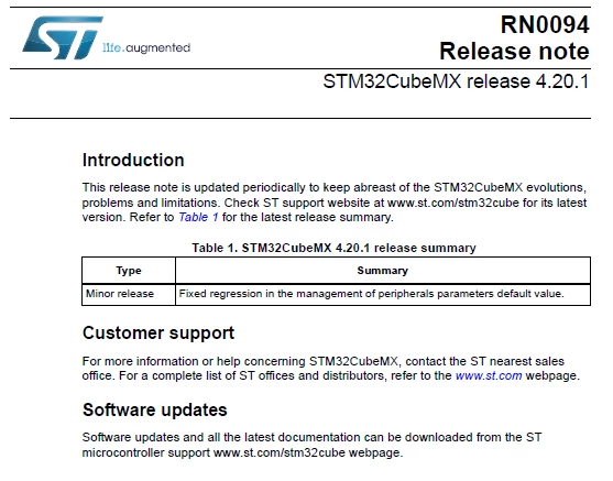

I recently installed cubemx 4.20 latest version 4.20.1
I can generate the project only 1 time, later if i try to update the project by adding new peripherals, i can not able to generate the code, the whole application is stuck in 'Generating user source code '. the only way i can close this application is killing it by 'Task manager'. it happens every time. Please help
    Best answer by Jeanne Joly
    Posted on April 12, 2017 at 15:15
    Hello
    n.serina
    In fact, the problem you highlighted is solved in CubeMX4.1.
    Please, upgrade with the latest release of CubeMX.
    Here is a screen shot of the CubeMX4.1 release note :
    Hope it will help you and that you won't encounter this issue in the future.
    BR. Eric
