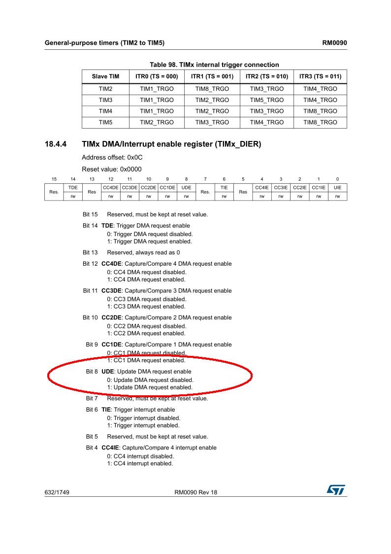

waclawek.jan
April 8, 2020
> TIM4 -> DIER |= (1UL <<(14U)); // UPDATE DMA REQUEST ENABLE
Are you sure? I don't have RM at hand but this doesn't sound right to me.
Why don't you use the symbols from the CMSIS-mandated device header?

PPiro.1
PPiro.1Author
April 8, 2020
Hi JW,
I'm sorry, I had this register set as:
TIM4 -> DIER |= TIM_DIER_UDE
and it didn't work for me so I started to mess around and forgot to put it back to what it was originally.
It is back to TIM4 -> DIER |= TIM_DIER_UDE .

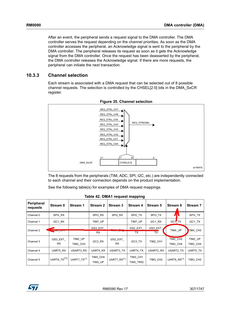

waclawek.jan
April 8, 2020
> |( 1 * DMA_SxCR_CHSEL_2) // CHANNEL 2 SELECTED
No. DMA_SxCR_CHSEL_2 is bit 2 of the CHSEL bitfield, so this sets the CHSEL bitfield to 0b100 = 4 i.e. you've selected channel 4.
You want
|( 2 * DMA_SxCR_CHSEL_0) // CHANNEL 2 SELECTED
or, maybe visually better, if you have newer header file (the ***_Pos symbols were not defined in the headers in the SPL era)
| (2 << DMA_SxCR_CHSEL_Pos)
> TIM4 -> DIER |= TIM_DIER_UDE; // UPDATE DMA REQUEST ENABLE
yes, that's better than triggering DMA from CC3, but then you need not Channel 7 but channel 6:
If after doing this still no cigar, read out the registers' content in debugger and check/post.

waclawek.jan
April 8, 2020
We are not talking about signals going in/out from/to pins, but signals which go to the DMA unit as requests (i.e. which "trigger" one DMA transfer).
These are the signals which are enabled in the upper part of TIMx_DIER register.
TIMx_UP request in DMA comes from the Update signal (i.e. signal which is generated mainly at the timer's "overflow"), as enabled by TIMx_DIER.UDE.
TIMx_CH3 request in DMA comes from the Capture-Compare unit 3, ie. when Capture or Compare occurs, as enabled by TIMx_DIER.CC3DE.
You want the DMA transfers to happen at Update, as that gives the most time for the DMA to accomplish the transfer until the next Update (which would then transfer the freshly written value from CCR3 to the "shadow" register i.e. the internal register against which the actual Compare is performed).
