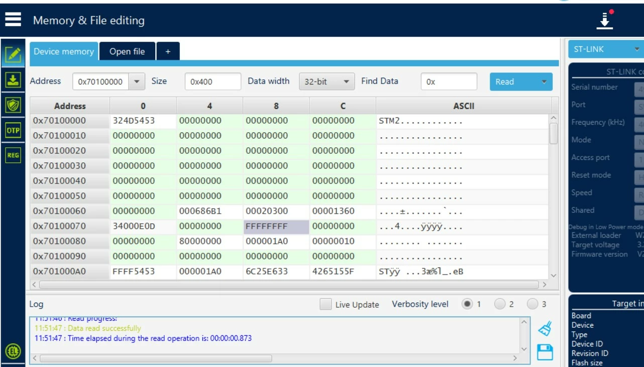

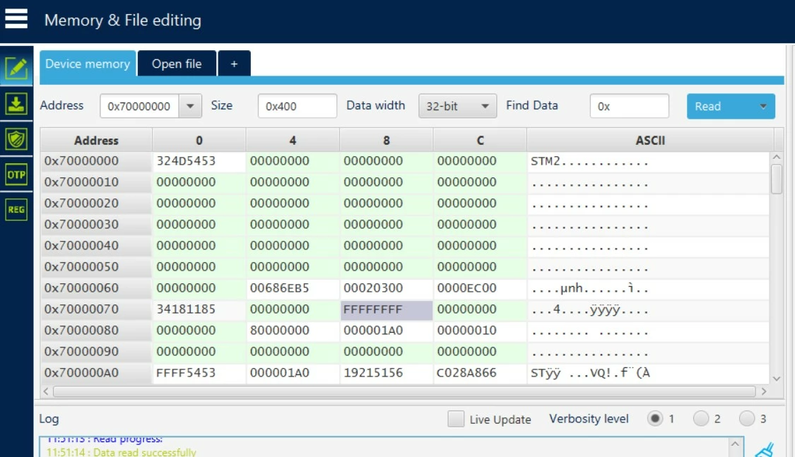

    I have designed a custom PCB using STM32N657I0HxQ and W25Q32JWZPIQ NOR flash. I am following the STM32N6 FSBL Load & Run tutorial https://community.st.com/t5/stm32-mcus/how-to-create-an-stm32n6-fsbl-load-and-run/ta-p/768206 , but have trouble getting the application running. I am using below setup:
STM32CubeIDE - v1.19.0
STM32CubeProgrammer -v2.21.0
STM32CubeMX - v6.15.0

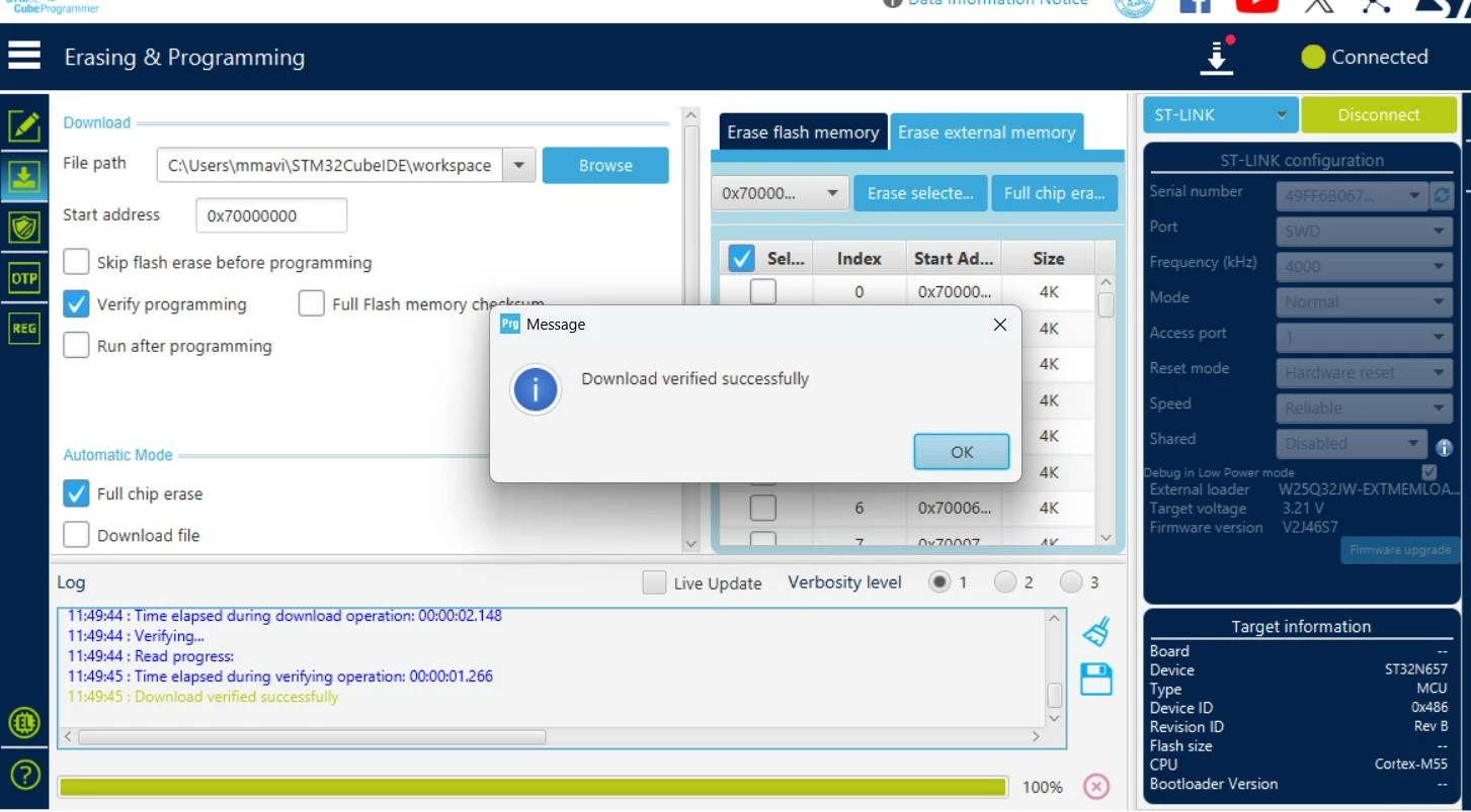

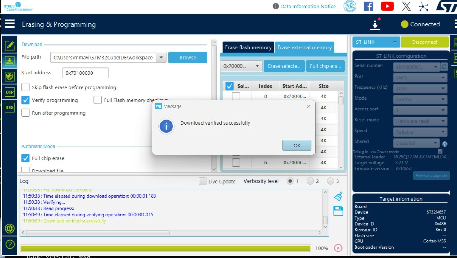

I have created a custom external memory loader for W25Q32JWZPIQ and able to connect device in Dev boot mode (BOOT1 -1, BOOT0-0) and flash FSBL-trusted.bin and Appli-trusted.bin at 0x70000000 and 0x70100000 respectively. Also, I am able to verify the contents.
 When I connect to Flash boot mode (BOOT1-0, BOOT0-0), Led is not blinking.

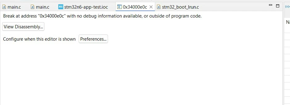

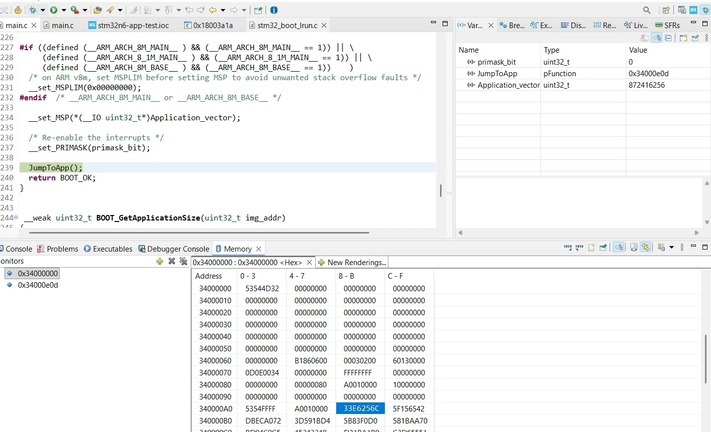

I tried to debug by setting device into Dev mode and run FSBL directly into internal RAM, I can see the FSBL is properly copying the application code to 0x34000000 but JumpToApp() ends up in fault.

FSBL-trusted + Appli-trusted(Led toggle) + ExtMemLoader - FSBL and Appli loads into internal RAM but crashes at JumpToApp().

Best answer by avinashmm
I am able to flash and run application after downgrading stm32cubeprogrammer to v2.20.0. For latest version, we need to add "-align" parameter in signing command.
