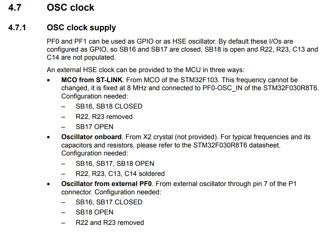

However, on the STM32F030 DISCOVERY board, there is such a resistor – R22 – even though the crystal is not installed by default. I added the crystal I wanted to use and measured the current through it (using a current clamp), and it became clear that it was being driven beyond its specified power limits. That’s when I realized the need for the series resistor (R22). I calculated the appropriate resistance value and installed it – but it didn’t reduce the current through the crystal at all.
After further investigation, I discovered that the OSC_OUT pin on the microcontroller is actually a high-impedance input, while OSC_IN is the output. So I tried placing the resistor in series with OSC_IN instead – and, as expected, this reduced the power dissipated in the crystal.

Did you also remove  SB16 et al - to disconnect the drive from the ST-Link?

The issue was indeed caused by the SB18 solder bridge being in place. After I removed it, everything started working as expected. That is, OSC_IN is the input and OSC_OUT is the output. So, to limit the drive level, the R22 resistor on the STM32F030 DISCOVERY board should be used.
