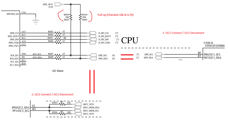

I am working on a project using stm32f429IIt6.
I'm currently having an I2C problem at the end of my project.
I2C1 uses PF 0, 1 / I2C2 uses PB 6, 7. The HW PCB completed, and the HW I2C pull up is the same.
In I2C1 HAL code, the entire initialization does not work, and if I2C2 is used with the same code, it works well.
I am using various Pheripherals such as TIM Interrupt. Is there any conflict?
Is there any difference between I2C1 and I2C2?

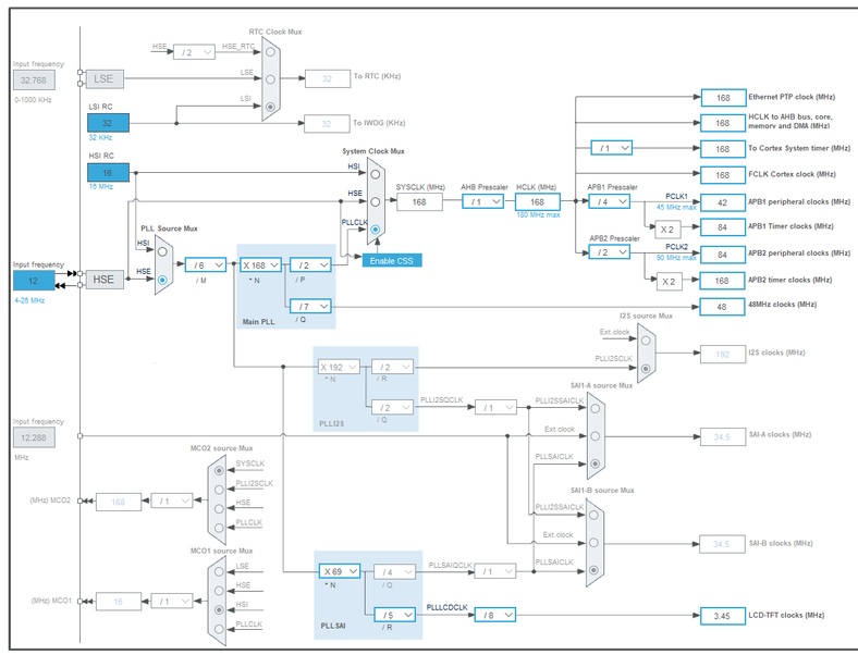

In the TIMER part, it appears to share APB1.

You mean I2C1 on PB6/7 and I2C2 PF0/1.
Is there any I2C error flag set when using I2C1?
Does your PCB allow you to use PB8/9 instead of PB6/7 for I2C1?
-Amel
Andrew Neil
January 22, 2025
Please show the PCB schematic.

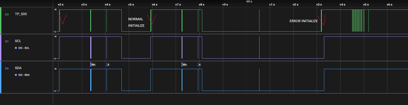

And I use TIM1(PWM), TIM2(Timer interrupt count), TIM4(PWM), TIM5(for us Delay Timer Count), TIM8(Input Capture mode)
in Debug mode I2C Master Transmit in to HAL BUSY Flag
Not initialize to HAL_I2C_STATE_READY

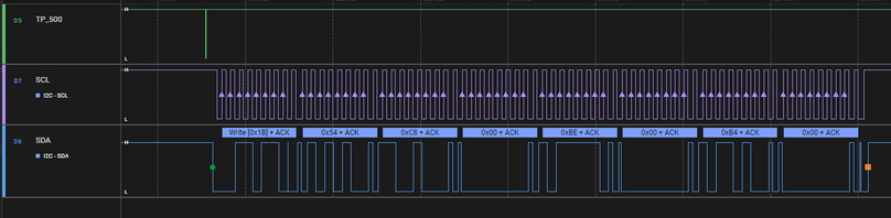

here is logic analyzer sequence
Above one is normal intialzie and normal I2C communication sequence
I Think I2C1 is not working in abnormal initialize

Main issue is I2C1 go to HAL BUSY Flag.. and system locked.
I think Not initialize to HAL_I2C_STATE_READY
This situation is often seen when you turn it on after first connecting the power, and it's working well afterwards.
