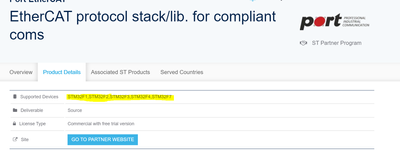

I wanna implement Master and Slave ethercat protocol on stm32h7 series. Is there any examples available on subject?. Where should i start. Any resources?
STea
Hello @Legacy member ,
unfortunately the STM32H7 series is not supported in the port of EtherCAT protocol stack/lib supported by ST as shown in this screenshot below
more details on this in our website.
