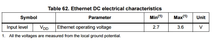

Hi there,
As mentioned above, I need to operate STM32F2 at 2.5V and the peripherals which i am gone use are USART, I2C, FSMC, ETHERNET, USB_FS. I have seen the datasheet for limitations depending on operating power supply. which has mentioned about ADC and fsmc clock limitations, what other issues I may face while accessing these peripherals?
Thanks

    The USB drivers have minimum voltage requirements.

    Hi
    Dhuri.Pranay
    For the Ethernet:
    For USB:
    The USB is functional, including its internal transceiver, only for VDD >= 2.7 Volts.
    For VDD < 2.7 V, we are not guaranteeing that our internal transceiver is functional at all temperature and process variation.
    However, to be compliant with USB specification, you need to have minimum of 3 Volts.
