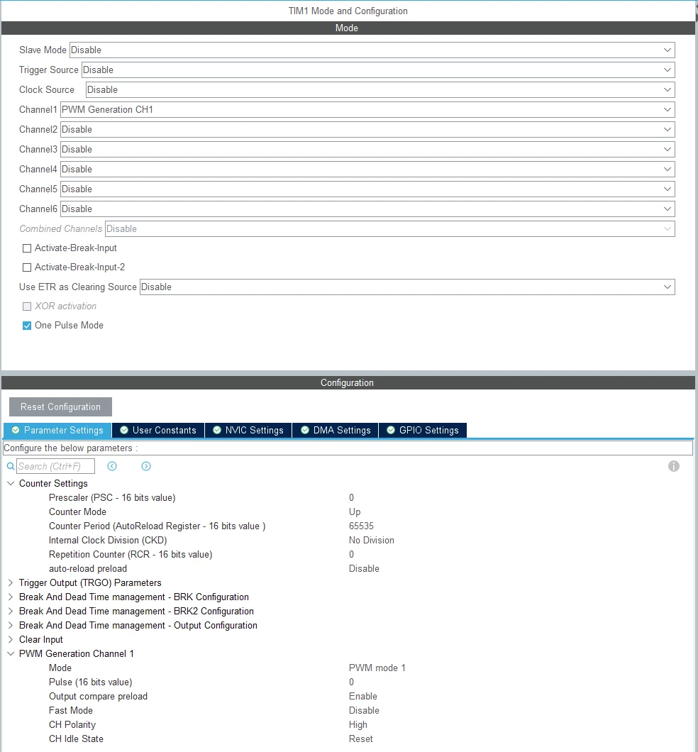

no clock, really?
0693W00000WIC15QAH.pngshould be:
EMach.3
EMach.3Author
November 13, 2022
emm...I don't know why. But yes, the timer goes well without selecting a clock source in CubeMX. Maybe the default is Internal Clock. And I have just tested to set the Internal Clock. But the problem remains even when the frequency is just 20kHz.

Read out and check TIM registers content just before the counter gets enabled. That probably involves stepping through Cube code (which is open source so it's perfectly okay). Note, that RCR is effectively preloaded, i.e. it does not get effective until the next Update event.
If you do anything which is not supported directly by clicking in CubeMX, Cube may get into way more than help. Don't use Cube. Timers are not that hard to manage. You can play with them without writing code, in the debugger, to get the grips.

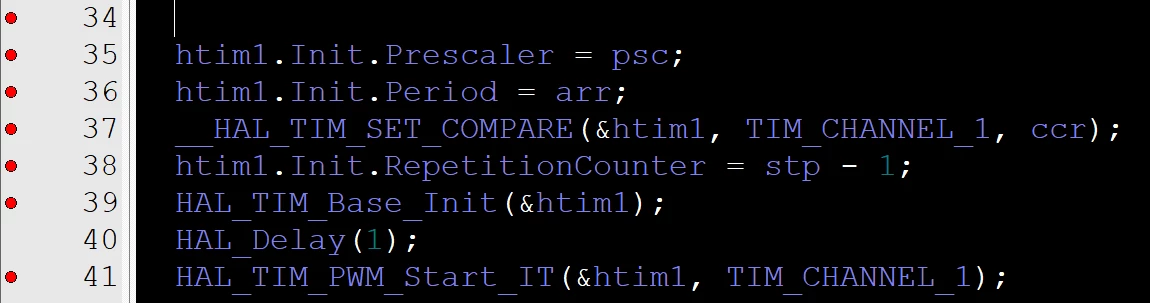

Thank you! I just checked the content of every register of TIM1 in debug mode. I found the cotent was accurate in debug mode. And the pulse count was also accurate up to 200kHz. The difference between debug mode and normal startup, I think, is the delay between breakpoints. So I just add a 1ms delay and the problem disappears.
0693W00000WIDOPQA5.pngMaybe it needs some time to reload the register...

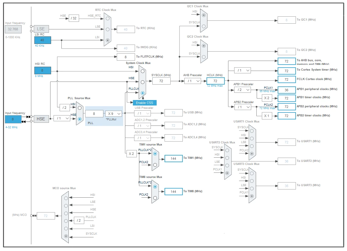

There are many things wrong. As already noted, several timer registers are preloaded. The timer clock is not 144 MHz - even the CubeMX shows it clearly and correctly.

72 MHz / 2^16 / 50 Hz = 21,97 = 22
Set a prescale factor to 22 and pulse width to a constant value. Now you can get your range from 50 Hz by just adjusting the period and it still has a 16-bit resolution. At the highest speeds the period of 16 counter ticks gives 204,5 kHz and a 17 ticks gives 192,5 kHz. Should be good enough resolution for many purposes.
