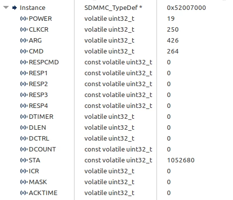

STM32H743i-EVAL w/BSP V1.11.0
SD Cards:
16GB SanDisk MicroSDHC I C4 (circle C with number inside)
16GB SanDisk MicroSDHC C2

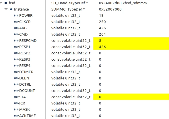

Both cards are supposed to be V2.0. Both work in all the SD devices (cameras, PC, thumb drive adaptors, USB readers). When used in the eval board one ( I C4) fails and the other passes initialization. The point of failure is found in stm32h7xx_hal_sd.c at line 3155 where an attempt is made to send the CMD8 app command. The errorstate returned is 4. It does not always fail which makes wonder if there is a timing problem, however when it does fail it is always the same card that is the SDHC I C4 which I believe is the faster card.
When the command passes on the failing card the hsd>instance structure looks like this:
0693W00000Y9t8OQAR.pngWhen it fails it looks like this:0693W00000Y9t7rQAB.pngAlong the way, while looking for possible timing problems I came across this in stm32h7xx_hal_s at line 519:

This is not about data throughput. It is about basic command response when trying to initialize the card. AScha, your SDMMC1,2 clock is fine. Mine is 200MHz. I have also used 50MHz. What matters is the clock divider in the parameters for the SDMMC clock divide factor that results in the final maximum clock driven to the SD card. This will affect the throughput on a burst. However, this is of no consequence because during initialization the SD card clock line is throttled back to 400KHz. I have seen other implementations throttle back to 100KHz.
I am not certain, but I suspect the problem has something to do with a register not being handled correctly either on the driver side or on the card side. I think that because it looks like, from what I provided for the instance structure, that the CMD8 is not responding as the RESPCMD and RESP1 registers are 0 for the card that does not work.

Still would like some feedback on the strange HAL delay equation and its relevance as well as what might be learned from the hsd instance data response for the CMD8 command.
