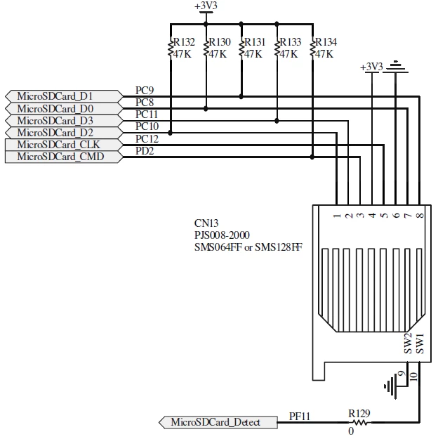

    Hi Clive,
    I have to thank you one time more ! This is the best starting place to deal with USB Mass storage, as you already point to me.
    But would it be better for me to begin with 2.1.0, for any reason ? I'd like to support uSD card support up to 4G if possible.
    I probably have to tweak a bit, because:
    - I have no Card Detect in my layout,
    - and my USB D+ is always pull up (no reset possible)
    Is that true ?
    But it may be ok with an external 8MHz crystal HSE on STM32F103_RC, or _RE ?
    Many Tx, as usual ;)
    Tesla DeLorean
    Guru
    September 27, 2013
    Posted on September 27, 2013 at 13:52
    I think this would be a good starting point. The SDIO pins don't provide many options, but you can pick any available GPIO for the Card Detect switch on the socket. Pull-ups close to the socket are important, as are short, uniform length wiring. Review the schematic for the STM3210E-EVAL
    The code should support cards upto 2 GB, I've modified other examples to use block addressing, and these should work up to 128 GB and beyond. I haven't played with the F1 drivers.

    My first test with 2.0 on my custom board are unsuccessful (running on HSE 8MHz crystal), the SD_PowerON() function crash after ACMD41, with a response of 16744448 at the second attempt (count=1).
    Do you think it can be related to a clock malfunction, or anything else ?
    Perhaps I did something wrong in my layout too ? My CMD line is jumped over the CLK line, with a strap jumper R0. I used 47K pull-up (and 10K for CMD line).
    Tx again for your help ;)
    Tesla DeLorean
    Guru
    September 30, 2013
    Posted on September 30, 2013 at 15:44
    I used 2.1.0 rather than fight my way through the older version. The code is usable for SD and SDHC cards.
    The wiring for the Micro SD card socket is pretty simple, and consistent across STM32 platforms. Stick with a known working design
