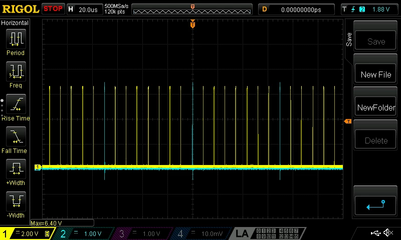

PIvan.9
PIvan.9Author
January 25, 2022
Hi Philippe,
Thanks for your time and trying to help.
So far, I've figured out that the false values the ADC stores in its data register are all equal to exactly 4095. I've double checked that the ADC inputs are not connected to anything other than GND and I've also measured them with oscilloscope, they are actually at 0V as expected.
The only way I can check ADC readings is with if condition and GPIO toggling, since I don't have any communication protocol connection (I2C, UART, SPI) on my board.
After setting up oscilloscope, it looks like most of the readings are the false ones and the one that should have a proper low value appears once in 8 readings. See the graph below, yellow line is pin toggling at values 4095, blue is another pin toggling at values lower than 500.
Changing sampling time only affects the period between readings/pin toggling, but it doesn't fix anything.
I don't have any explanations for this behaviour from my side, since power supply is designed properly in my opinion. Also, bad supply wouldn't explain why this issue appears only during enabling PWM output on one specific channel and disappears when a channel is changed to another one. Also, I don't think that the current draw can be the reason, since PWM pin is disconnected and duty cycle is set to 100%.
