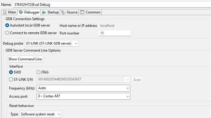

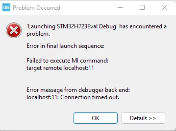

I'm trying to do the same, debug two target boards at the same time when both are running. How to set the debug port number to make it connect to the different board?
0693W00000aJgBwQAK.pngWhen I change debugger configuration by using the port number from Port COM 10 or 11, I'm getting connection error
0693W00000aJgC1QAK.pngSo far, only use Autostart localhost, by connecting one board at a time works.
0693W00000aJgCLQA0.pngThanks
ETong.1
March 25, 2023
Select ST-LINK S/N with the scanned value can find the right board now.

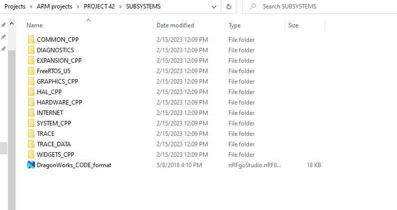

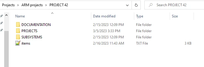

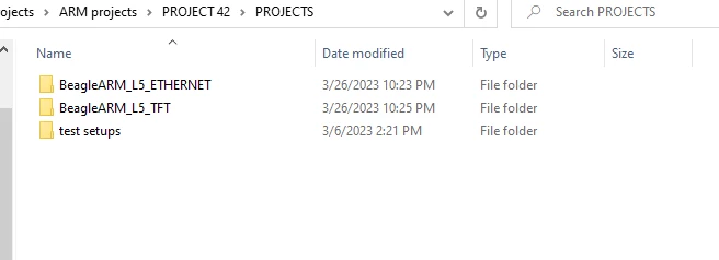

I've had some problems with how CubeMX finds files, so I've had to resort to absolute paths. Because of this, I've tried things and the existing structure of my project reflects the experiments (that didn't work). I've tried relative paths, and the like, and I found that project properties/paths entries don't work well for me. I've resorted to absolute paths. Because the project structure is similar for many projects of this type, the absolute paths work from project to project.
The basic project structure (modified from the default) is to add SUBSYSTEMS, which is a file structure that has all of the common files. It does not include any unique files per project. Each file in SUBSYSTEMS is common to all projects.
0693W00000aJo7EQAS.pngNow the overall directory structure is
0693W00000aJo8vQAC.pngand the project directory is
0693W00000aJo9PQAS.pngand just for fun, the common files are:
0693W00000aJo9eQAC.pngNow, there's no reason that you have to follow this setup, but it does work for me.
In each file, as needed, insert the following which (as you see, has multiple projects under the same overall umbrella, using the same common files

when I created links by importing the files, I did not copy the files, I simply allowed it to link to existing files. (A little iffy on that, mostly because I've never seen a good explanation of what CubeIDE really does here. Major thing is not to copy files at all. Using the absolute paths gets rid of a lot of "I can't find it".
So for your specific questions or comments:
I use autostart GDB. I don't seem to have a problem there.
I just bypassed the relative path by using absolute paths. Because the major directory structure is independent of the project (see the project folder), for a particular incarnation of "I'm doing it this way", all of this is under Project 42, a number which may indicate the answer to everything <obscure reference>, the paths from part to part in the SUBSYSTEM files do not vary per project. Figure it out once, and it works.
Now, all this is under CubeIDE, so it produces a main.c file. The main.c file links to a C++ file "CPP_LINK", which sets up certain subsystems, mostly displays, I2C, and SPI. At this point, the overall system boot sequence can use an existing OLED display (small: 128 x 64).
CPP_LINK then calls a create routine which sets up the main project .cpp file. That conditionally sets up (using an included options.h with a lot of #define declarations) the subsystems: Networking, packets, mesh networking, display templates, various I2C hardware and the like.
Once this is done, there is a loop updating the status (OLED) display every five seconds or so.
The entire system runs on FreeRTOS, is written in C++, and is an event driven system (mostly). Touches on a display generally cause things to happen. External messages from other processors or processors in the mesh network cause things to happen.
It's a lot easier now, once I figured out this project structure. Is it perfect? no. Is it the only way to do things? no. Does it work? yes.
Hope that this helps and answers your questions.
Hope that this also helps others who stumble on this thread with much the same problems.
