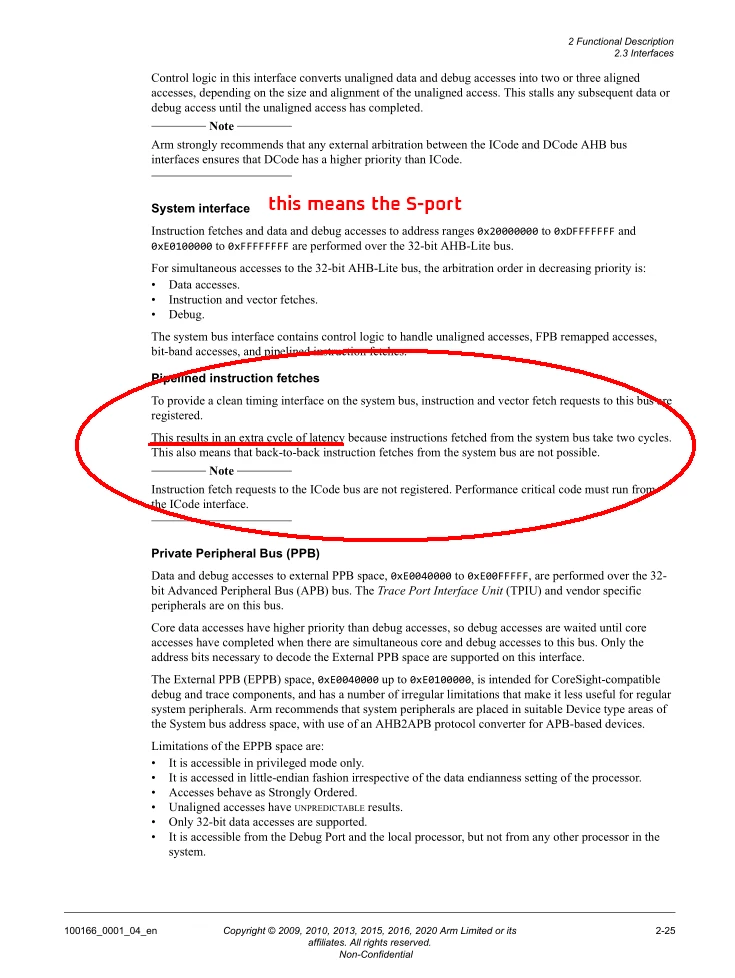

  • reads through S-port (i.e. above 0x2000'0000) in CM4 are inherently penalized by one extra cycle
  • there will be collisions on the S-port with data accesses from the processor (constants, variables, data, stack) -- both this and previous item is the reason for remap, read the STM32F4xx buses and bus matrix portion of Technical Update 1

The reads through the S-Port might explain it. Is there anywhere I can read up on this penalization? This would at least explain 1 out of the 3 extra cycles. I also tested running the binaries exclusively on SRAM3, where only the S-Bus is available, which interestingly changed the behavior from 4 to 9 cycles per instruction.
I am not sure if your other 2 points apply, as I am consistently getting the same cycle count for various binaries of same length (I tested a couple of thousand binaries with this setup - fixed set of instructions btw.) as I need a fixed length of cycles. Stack is in a different SRAM.
Good to know that the RM isn't that precise!
(EDIT) your edit about the collisions on the S-port most likely explains it. I will check the technical update.
LukasG
LukasGAuthor
September 8, 2022
Your two points on the S-Port seems to explain my trouble @Community member​. Thanks a lot! I guess there is not much I can do about this penalization. :) I suppose I could try to do the physical remap of SRAM1 as this seemed to increase performance quite a bit.
