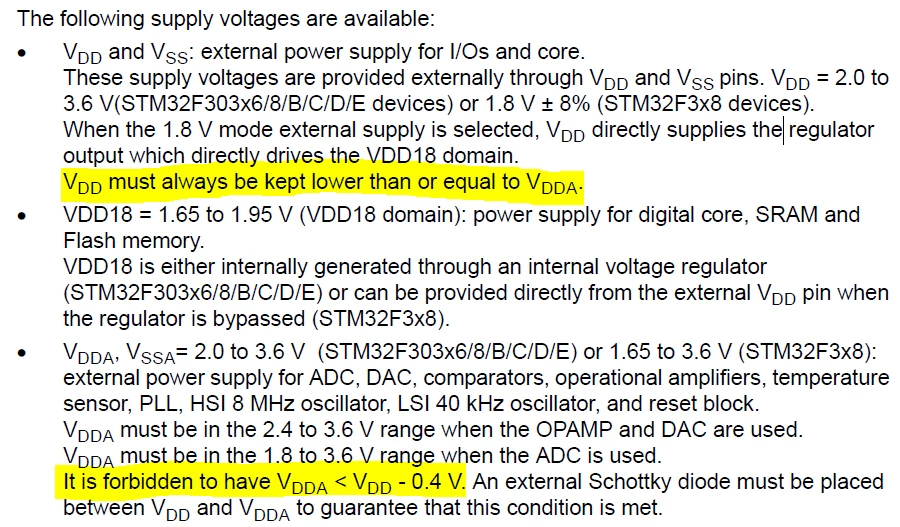

The reference manual lists some rules for this scheme. Probably other info in there as well.

which manual is this?
I can't find that first condition in mine.

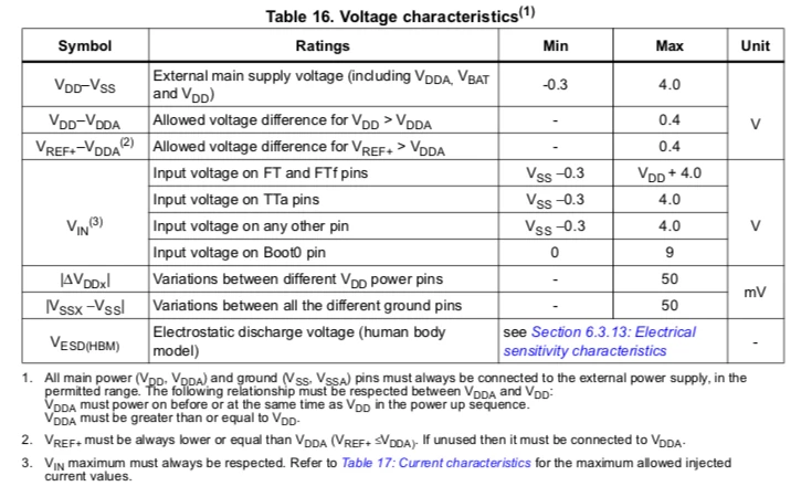

Seems Vdd can go higher than Vdda in terms of maximum ratings. It's the impact on accuracy I'd have to find out.
f303xE datasheet

Any idea what the effect might be if Vdd is slightly higher than Vdda? got a 0.4% difference at 3.3V = 13.2mV difference possible with my comps, MCP1501 is the main reg. I doubt it's important but I'll have to check now :\

As the datasheet states you should definitely avoid higher voltages at VDD compared to VDDA, while 400mV is the maximum difference.
It depends on your settings and hardware, if the resulting measurement showing some difference.
