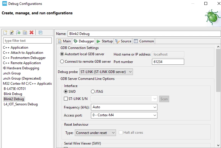

DNeet.1
DNeet.1Author
June 22, 2020
ST-LINK: V2.J34.M25
STM32CubeIDE: Version: 1.3.1
I'm using GDB-Server. Wherre can I find the Version No.?
DNeet.1
DNeet.1Author
June 23, 2020
Thx for the advice. I updated to V2J36 and this is working now.
