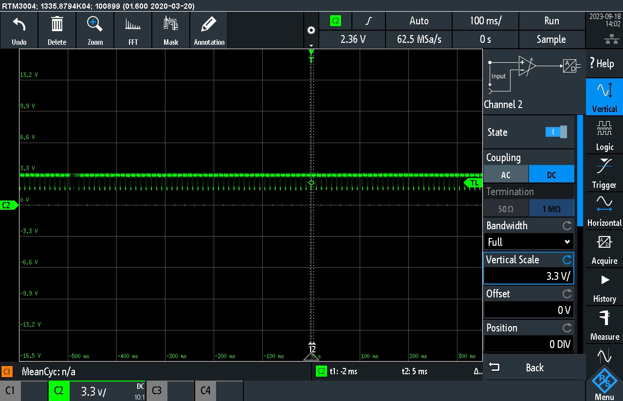

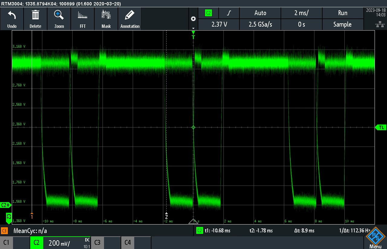

Whenever the this jumper is not shorted/ is open, so it is not supplying the STM, the voltage reading I measure seems perfectly fine. However, once I short it and allow the STM to be supplied by this 3V3 rail, I notice the behaviour depicted in the pictures below.
It seems like some kind of protection is being triggered, however so far I have not been able to find what the issue is.  At the same time, I notice that the STM is getting quite hot.
I would really appreciate any suggestions or recommendations.

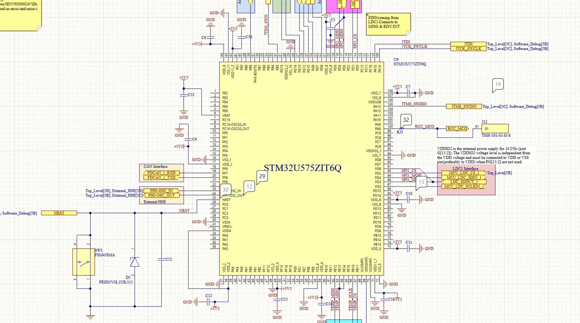

I just included an image of my schematic.
I have checked the orientation and pins of the component and those seem to be fine.
So I am currently suspecting that there is something else that I am missing.

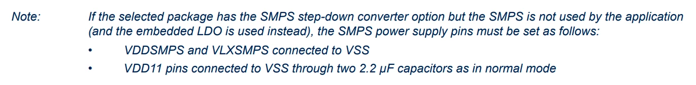

VDD11 shouldn't be connected to 3.3V. It should only have a capacitor to ground, on both pins, if you're not using SMPS.
Per the hardware layout guide:
https://www.st.com/resource/en/application_note/an5373-getting-started-with-stm32u5-mcu-hardware-development-stmicroelectronics.pdf

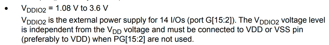

Might not be killing you here, but VDDIO2 is required per the datasheet, and since you're using pins supplied by that rail.

An update:
I have desoldered the pins and have connected them based on the recommendations above. The VDD pins are now reading 1.1V and the issue described above is solved.
