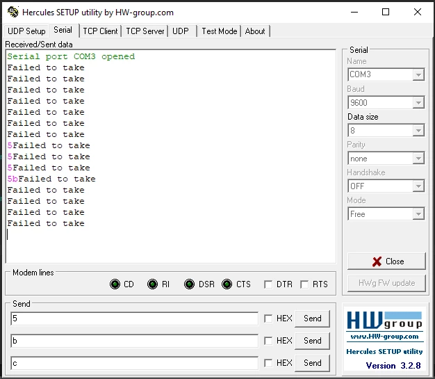

The device I am using is F303K8T6.
I am trying to learn. I have no problem with transmitting.
But when it comes to receive data it don't works. Interrupt not rises.
But when I connect tx pin to rx pin it works well. Interrput rised.
The code and concerning images is as following.

0693W00000Y9or4QAB.pngThe picture above shows that transmisson works. But receiving don't works well.

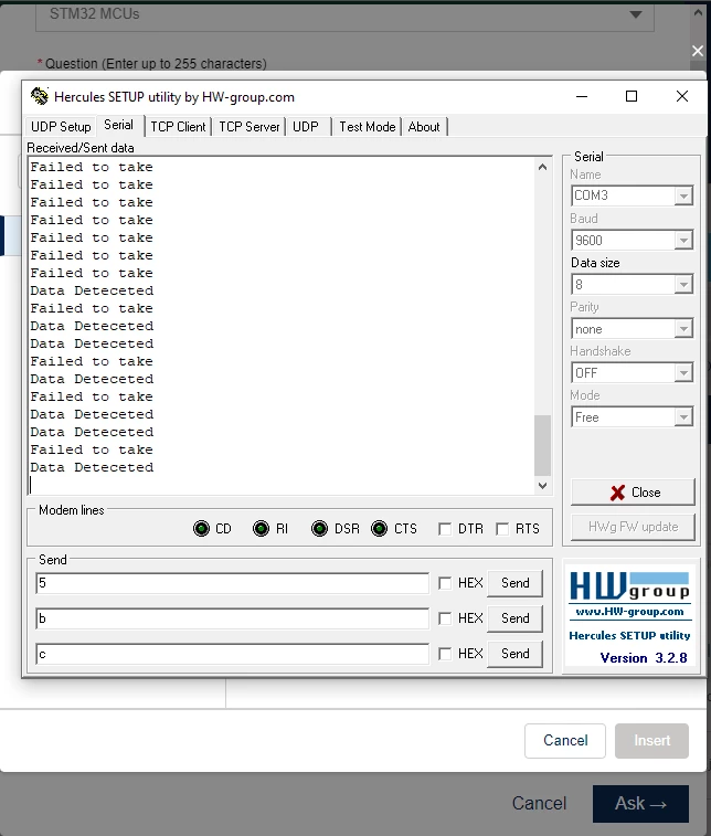

0693W00000Y9orFQAR.pngThe picture above shot when TX RX pin are shorted. Interrupts are rising.
Any idea why I can't receive data through my computer ?

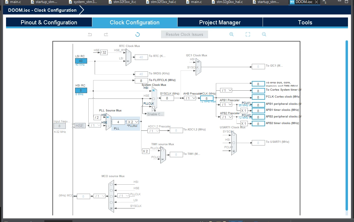

The full code and clock scheme is as follows.
