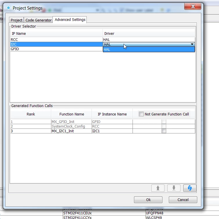

achin
achinAuthor
March 9, 2017
Posted on March 09, 2017 at 20:22
I installed this. When I go to ''settings'' it does not allow me to select LL drivers. 0690X00000606X0QAI.png
Technical Moderator
March 13, 2017
Posted on March 13, 2017 at 17:14
Hi chin.andrew,
The support of LL drivers is available for STM32CubeF4 firmware package but not yet supported in CubeMx.
Thanks
Imen
