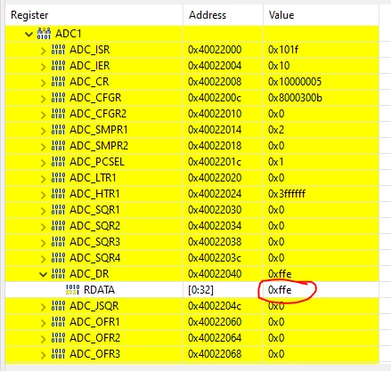

I configure the ADC1 of the STM32H735 like bellow:

The ADC1_DR register = 0xFFE (I put 3.3V in PA0_C pin) it is ok.
_legacyfs_online_stmicro_images_0693W00000biUC8QAM.pngbut in the buffer, the dma transfer only the first byte :
_legacyfs_online_stmicro_images_0693W00000biUKvQAM.pngI did not understand why the DMA always transfers a Byte despite I made several configuration combinations.

Please show us the buffer declaration and how you start DMA.

LCE
Principal II
April 20, 2023
Looks exactly like my working H7 ADC code.

LCE
Principal II
April 25, 2023
Nice that it's working now!
Are you sure that you didn't change stuff elsewhere, like:
  • clock settings
  • DMA interrupts
Oh, I just see the old CubeMX problem, putting DMA init after peripheral init using DMA.
In your 2nd source code post it is:
MX_GPIO_Init();
MX_ADC1_Init();
MX_DMA_Init(); <<<< this must be before any peripheral using DMA!
I guess you changed your main, maybe by updating CubeMX?
Known bug, and it bugs me that I haven't seen that earlier! ;)
