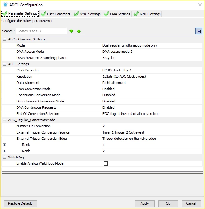

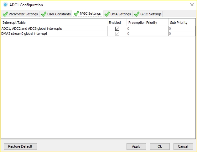

static void MX_ADC1_Init(void)
 ADC_MultiModeTypeDef multimode;
 ADC_ChannelConfTypeDef sConfig;
 /**Configure the global features of the ADC (Clock, Resolution, Data Alignment and number of conversion)
 hadc1.Instance = ADC1;
 hadc1.Init.ClockPrescaler = ADC_CLOCK_SYNC_PCLK_DIV4;
 hadc1.Init.Resolution = ADC_RESOLUTION_12B;
 hadc1.Init.ScanConvMode = ADC_SCAN_ENABLE;
 hadc1.Init.ContinuousConvMode = DISABLE;
 hadc1.Init.DiscontinuousConvMode = DISABLE;
 hadc1.Init.ExternalTrigConvEdge = ADC_EXTERNALTRIGCONVEDGE_RISING;
 hadc1.Init.ExternalTrigConv = ADC_EXTERNALTRIGCONV_T1_TRGO2;
 hadc1.Init.DataAlign = ADC_DATAALIGN_RIGHT;
 hadc1.Init.NbrOfConversion = 2;
 hadc1.Init.DMAContinuousRequests = ENABLE;
 hadc1.Init.EOCSelection = ADC_EOC_SEQ_CONV;
 if (HAL_ADC_Init(&hadc1) != HAL_OK)
 _Error_Handler(__FILE__, __LINE__);
 /**Configure the ADC multi-mode
 multimode.Mode = ADC_DUALMODE_REGSIMULT;
 multimode.DMAAccessMode = ADC_DMAACCESSMODE_2;
 multimode.TwoSamplingDelay = ADC_TWOSAMPLINGDELAY_5CYCLES;
 if (HAL_ADCEx_MultiModeConfigChannel(&hadc1, &multimode) != HAL_OK)
 /**Configure for the selected ADC regular channel its corresponding rank in the sequencer and its sample time.
 sConfig.Channel = ADC_CHANNEL_3;
 sConfig.Rank = ADC_REGULAR_RANK_1;
 sConfig.SamplingTime = ADC_SAMPLETIME_15CYCLES;
 if (HAL_ADC_ConfigChannel(&hadc1, &sConfig) != HAL_OK)
 sConfig.Channel = ADC_CHANNEL_4;
 sConfig.Rank = ADC_REGULAR_RANK_2;

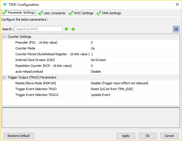

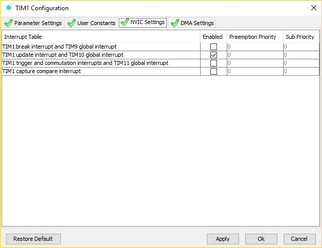

/* TIM1 init function */
static void MX_TIM1_Init(void)
 TIM_ClockConfigTypeDef sClockSourceConfig;
 TIM_MasterConfigTypeDef sMasterConfig;
 htim1.Instance = TIM1;
 htim1.Init.Prescaler = 0;
 htim1.Init.CounterMode = TIM_COUNTERMODE_UP;
 htim1.Init.Period = 1;
 htim1.Init.ClockDivision = TIM_CLOCKDIVISION_DIV1;
 htim1.Init.RepetitionCounter = 0;
 htim1.Init.AutoReloadPreload = TIM_AUTORELOAD_PRELOAD_DISABLE;
 if (HAL_TIM_Base_Init(&htim1) != HAL_OK)
 sClockSourceConfig.ClockSource = TIM_CLOCKSOURCE_INTERNAL;
 if (HAL_TIM_ConfigClockSource(&htim1, &sClockSourceConfig) != HAL_OK)
 sMasterConfig.MasterOutputTrigger = TIM_TRGO_UPDATE;
 sMasterConfig.MasterOutputTrigger2 = TIM_TRGO2_UPDATE;
 sMasterConfig.MasterSlaveMode = TIM_MASTERSLAVEMODE_DISABLE;
 if (HAL_TIMEx_MasterConfigSynchronization(&htim1, &sMasterConfig) != HAL_OK)

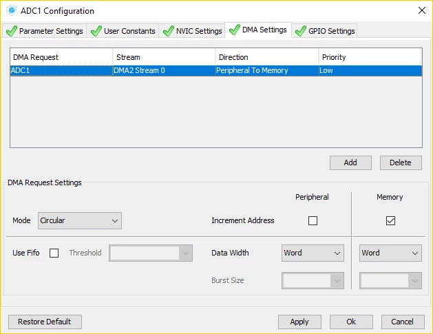

static void MX_DMA_Init(void)
 /* DMA controller clock enable */
 __HAL_RCC_DMA2_CLK_ENABLE();
 /* DMA interrupt init */
 /* DMA2_Stream0_IRQn interrupt configuration */
 HAL_NVIC_SetPriority(DMA2_Stream0_IRQn, 0, 0);
 HAL_NVIC_EnableIRQ(DMA2_Stream0_IRQn);

I start TIM1 in
void TIM4_IRQHandler(void)
 HAL_TIM_Base_Start_IT(&htim1);
and stop TIM1 in
void TIM1_UP_TIM10_IRQHandler(void)
 HAL_TIM_Base_Stop_IT(&htim1);
I start the ADC DMA in
 HAL_ADC_Start(&hadc2);
 HAL_ADCEx_MultiModeStart_DMA(&hadc1, (uint32_t*)&m_adc_buf, 4);
and stop ADC DMA in
void HAL_ADC_ConvCpltCallback(ADC_HandleTypeDef* hadc)
 HAL_ADCEx_MultiModeStop_DMA(&hadc1);
 HAL_ADC_Stop(&hadc2);

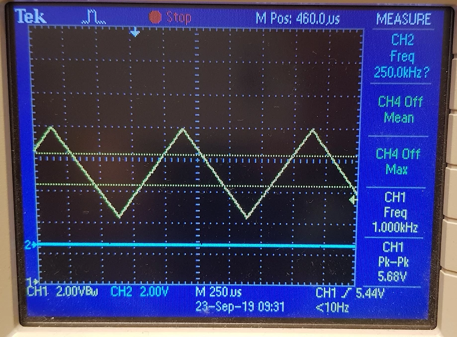

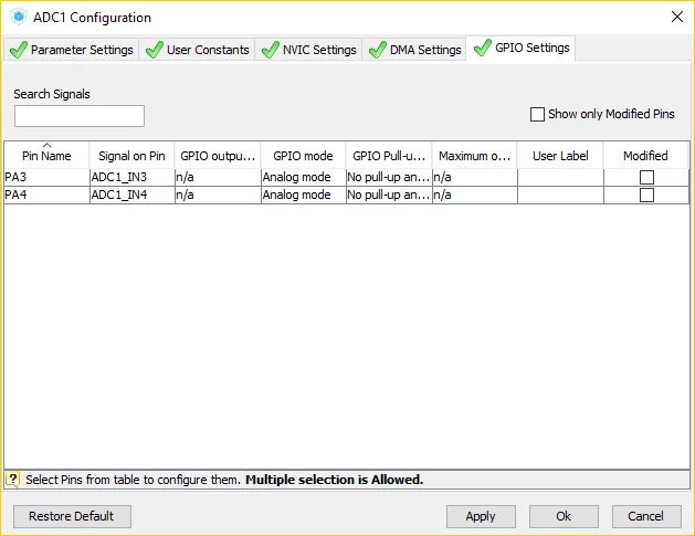

I'm using STM32F746, and the configuring is done with the HAL-library.

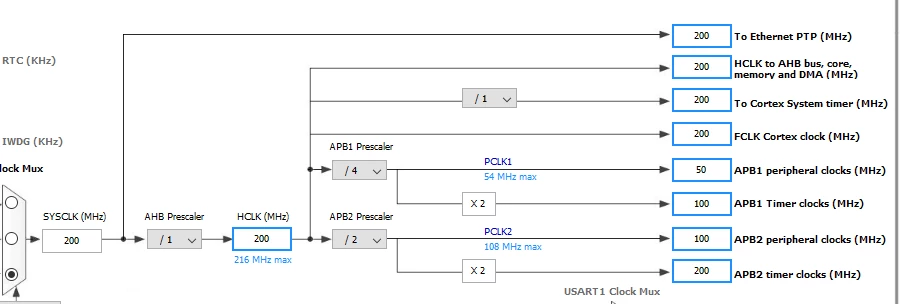

In the code below there is a 40 kHz TIM4 interrupt.
The ADC1 & ADC2 is configured in multimode which is triggered by TIM1.
I also use DMA for the ADC data transfer
Each ADC samples 2 channels (ADC1: IN3, IN4), (ADC2: IN5, IN6).
TIM1 is invoked in TIM4 interrupt handler and stopped in TIM1 interrupt handler.

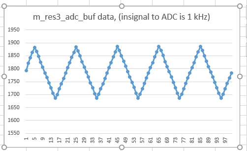

The 4 data from ADC1 & ADC2 are accessible in HAL_ADC_ConvCpltCallback()
The problem is that the ADCs only samples data with 20 kHz instead of 40 kHz.
I have try several different setting but I cannot increase the ADC sampling rate.
Can someone point out what I have done wrong?
As you can see I have enabled Scan Conversion Mode but disabled Continuous Conversion Mode
As I understand it, (when I read the STM32F746 user manual), it should be enough with one TIM1 trigger to the ADC, since the ADCs should the be responsible to sample all channels automatically and the invoke HAL_ADC_ConvCpltCallback() (when End of Conversion Selection = ECO flag at the end of all conversations).
I saw somewhere that someone suggested to activate the Continuous Conversion Mode to get all channels sampled when a timer is triggs the ADCs but I cannot find anything which confirms this in the STM32F746 user manual.
I have another problem too and that is that the only trigger event that is possible to use to trig the ADCs is timer 1 Trigger 2 Out Event. Why can I not use any other timer or events?
I have tried to trig the ADCs with timer 4. The settings I have tried are:
 TIM4                                        ADC1
  - TRGO update event              -> Timer 2 Trigger Out Event
  - Output Compare (OC1REF) -> Capture Compare 1 event
  - Output Compare (OC2REF) -> Capture Compare 2 event
  - Output Compare (OC3REF) -> Capture Compare 3 event
  - Output Compare (OC4REF) -> Capture Compare 4 event
Nothing above are working.

void SystemClock_Config(void)
 RCC_OscInitTypeDef RCC_OscInitStruct;
 RCC_ClkInitTypeDef RCC_ClkInitStruct;
 /**Configure the main internal regulator output voltage
 __HAL_RCC_PWR_CLK_ENABLE();
 __HAL_PWR_VOLTAGESCALING_CONFIG(PWR_REGULATOR_VOLTAGE_SCALE1);
 /**Initializes the CPU, AHB and APB busses clocks
 RCC_OscInitStruct.OscillatorType = RCC_OSCILLATORTYPE_HSE;
 RCC_OscInitStruct.HSEState = RCC_HSE_ON;
 RCC_OscInitStruct.PLL.PLLSource = RCC_PLLSOURCE_HSE;
 RCC_OscInitStruct.PLL.PLLM = 12;
 RCC_OscInitStruct.PLL.PLLN = 192;
 RCC_OscInitStruct.PLL.PLLP = RCC_PLLP_DIV2;
 RCC_OscInitStruct.PLL.PLLQ = 2;
 /**Activate the Over-Drive mode
 if (HAL_PWREx_EnableOverDrive() != HAL_OK)
 RCC_ClkInitStruct.APB1CLKDivider = RCC_HCLK_DIV4;
 RCC_ClkInitStruct.APB2CLKDivider = RCC_HCLK_DIV2;
 if (HAL_RCC_ClockConfig(&RCC_ClkInitStruct, FLASH_LATENCY_6) != HAL_OK)
 /**Configure the Systick interrupt time
 HAL_SYSTICK_Config(HAL_RCC_GetHCLKFreq()/1000);
 HAL_SYSTICK_CLKSourceConfig(SYSTICK_CLKSOURCE_HCLK);
 /* SysTick_IRQn interrupt configuration */
 HAL_NVIC_SetPriority(SysTick_IRQn, 0, 0);

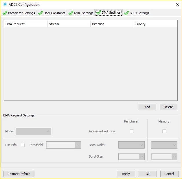

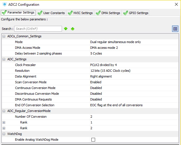

/* ADC2 init function */
static void MX_ADC2_Init(void)
 hadc2.Instance = ADC2;
 hadc2.Init.ClockPrescaler = ADC_CLOCK_SYNC_PCLK_DIV4;
 hadc2.Init.Resolution = ADC_RESOLUTION_12B;
 hadc2.Init.ScanConvMode = ADC_SCAN_ENABLE;
 hadc2.Init.ContinuousConvMode = DISABLE;
 hadc2.Init.DiscontinuousConvMode = DISABLE;
 hadc2.Init.DataAlign = ADC_DATAALIGN_RIGHT;
 hadc2.Init.NbrOfConversion = 2;
 hadc2.Init.DMAContinuousRequests = DISABLE;
 hadc2.Init.EOCSelection = ADC_EOC_SEQ_CONV;
 if (HAL_ADC_Init(&hadc2) != HAL_OK)
 sConfig.Channel = ADC_CHANNEL_5;
 if (HAL_ADC_ConfigChannel(&hadc2, &sConfig) != HAL_OK)
 sConfig.Channel = ADC_CHANNEL_6;

The ADC conversions finish time is 2,56 us
While the ADCs are triggered every 25 us so it should be plenty of time. (For each channel I use 15 cycles, but I have tried with 3 cycles and that does not help)
ADCCLK = PCLK2 / ADC CLK Prescaler
ADCCLK = 100 MHz / 4
ADCCLK = 25 MHz
Delay between 2 sample phases 5 cycles
ADC1&2 Rank 1 sampling time 15 cycles
ADC1&2 Rank 2 sampling time 15 cycles
Channel-wise sampling time
Tconv = Sampling time + 12 cycles
TConv = channel1 + channel 2
TConv = 15 + 12 + 5 + 15 +12 + 5
TConv = 64 cykles
ADC conversions finish time = 64 * 1/25000000
ADC conversions finish time = 2,56 us
Timer 4 interrupt handler is invoked every: 1/40 kHz = 25 us

The first image below shows that ADC samples only 20 samples during each period even when input signal i 1 kHz. The second image shows the input signal connected to the ADCs input channels.

Instead of invoke "start of timer 1" and "start ADC" in TIM4 IRQ. I let TIM4 be the master of TIM1 (so TIM1 is triggerd by TIM4)
by setting TIM1 to:
Slave Mode: External Clock Mode 1
Triger source to: ITR3
Then I set TIM1 to:
Slave mode controller to ERT mode 1
