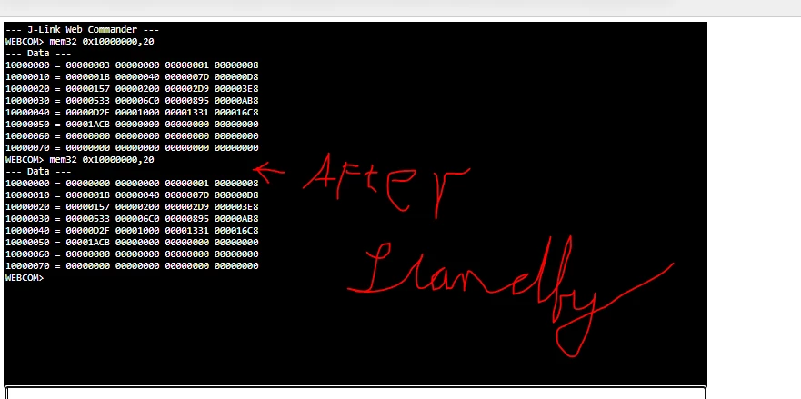

Hi STM32-Community,
I'm currently using an STM32L4R-MCU and was trying to set it up for standby. By using LoRa, I don't want it to keep requesting an OTAA-Command to join the network, I'm trying to use the SRAM2 Retention of my MCU in Standby-Mode. Googling and skimming through the datasheet, I only found at which adress the 64 KB SRAM are located, but how do I actually write to that memory and also read it back again?
I've neither found an application note, nor an example code. I would be really glad, if someone knows more about this topic.

I think I have understood it now.
For anyone wondering:
There is a .ld.file, in which the linker gets told, where it should save its data. You have to add RAM2 eg if you want to use SRAM2.
MEMORY
RAM (xrw) : ORIGIN = 0x20000000, LENGTH = 640K
FLASH (rx) : ORIGIN = 0x8000000, LENGTH = 2048K
RAM2 (xrw) : ORIGIN = 0x10000000, LENGTH = 64K
followed by
 .ram2 (NOLOAD):
 _sram2 = .;
 *(.ram2*)
 . = ALIGN(4);
 _eram2 = .;
 } >RAM2
Followed by this in the SECTIONS part.
Now data can be initialized within SRAM2 like this:
volatile uint32_t Counter __attribute__((section(".ram2")));
volatile uint32_t test123[20] __attribute__((section(".ram2")));
Et voilà:
0693W00000KbRLyQAN.pngI saved n³ (for n from 0 to 19) in test123, and counter was reset on purpose.
Thank you very much for your post, it helped me a lot!
Kind regards

Set up a segment in your linker script for SRAM2 and assign variables to be placed there, or create a pointer to that memory and store them manually.
Follow this, but use SRAM2 instead of CCMRAM:
https://www.openstm32.org/Using%2BCCM%2BMemory

Thank you for your reply. That looks very promising and I will try it out. Anyway, there is no application note directly from STM32? Those always have been very informative and usually worked flawlessly.
