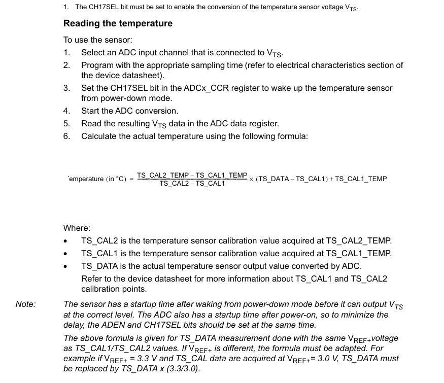

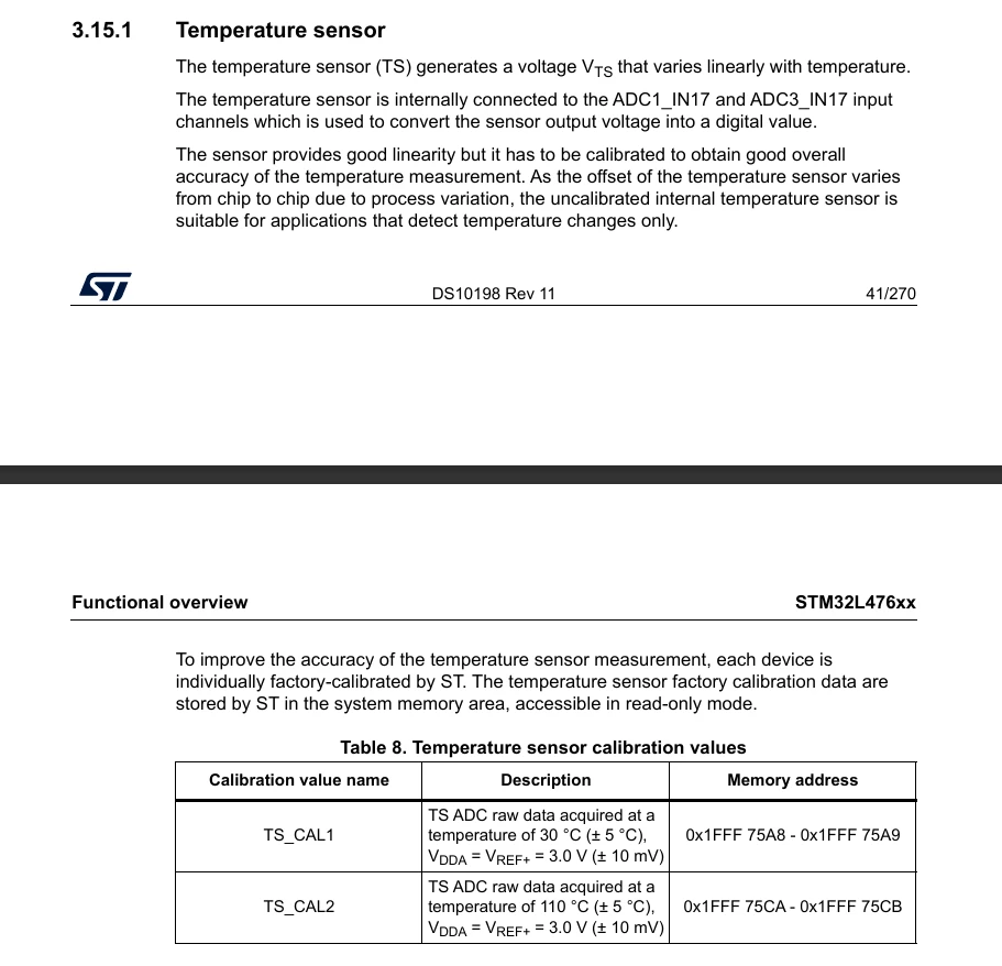

How are you calculating the Temperature from the ADC Data Register ?.
Have you calibrated the Internal Temperature Sensor according to the Reference Manual. ?
March 7, 2025
Are you following the procedure above ?

Thanks and yes I'm aware of the procedure and went over this several times. My implementation relies on the STM32 HAL.
The point is not about the conversion and calibration (by the way, after conversion I'm seeing temperature around 20-23C at ambiant so no issue there) but realy about the temperature sensor voltage that increase until 2100mV or so when I heat the sensor (which is expected) but then switch ti 690-700 when I continue to heat the sensor.

My suggestion is to log the ADC counts and the calculated temperature (in RAM during debugging or on PC by printing to UART/USART). Then use a spreadsheet to analyze it and verify/validate the calculation.
I also recommend measuring the VDDA to make sure it doesn't change.
The ADC needs to be calibrated during initialization.
Make sure the ADC doesn't sample the temperature sensor too fast. There is a minimal number of clock cycles required for measuring the temperature sensor. This is listed in one of the datasheets (I forgot which one).
