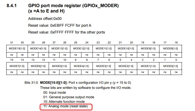

7.6 Unused I/Os and features
All microcontrollers are designed for a variety of applications and often a particular application does not use 100% of the MCU resources. To increase EMC performance and avoid extra power consumption, the unused features of the device should be disabled and disconnected from the clock tree. The unused clock source should be disabled and the unused I/Os should not be left floating. The unused I/O pins should be configured as analog input by software; they should also be connected to a fixed logic level 0 or 1 by an external or internal pull-up or pull-down or configured as output mode using software.
if it is already in reset mode then why have to configure in software? and why it makes a change while configuring in software as analog input then reset state by it self(without software config)?

> 0x0000000050000000 69EBFFAB
If configuration 1 and 3 are identical as far as the GPIO registers, I don't see how there could be a difference in power consumption.
But they're not at the reset values given in the RM, so perhaps you're doing something else in the code that is causing the discrepancy.
In your "configuration as analog input", PA9 is set to AF mode. So something else is going on.

yes,1 and 3 identical
But if you do not do software based initialization then it is taking analog (11) automatically.
but why 1 consume more power which is default than software based configuration in 3, is there any hidden configuration?
configuration as analog input and reset (no code initilization in sw) are identical
1(no code ) -- 01 10 10 01 11 10 10 11 11 11 11 11 10 10 10 11
2(input code init) -- 01 10 10 01 00 10 10 00 11 11 11 11 10 10 10 11
3(input analog code init )-- 01 10 10 01 11 10 10 11 11 11 11 11 10 10 10 11
and PA9 and PA10 is used as an uart but that are same to all configs. I don't think it has any impact.
