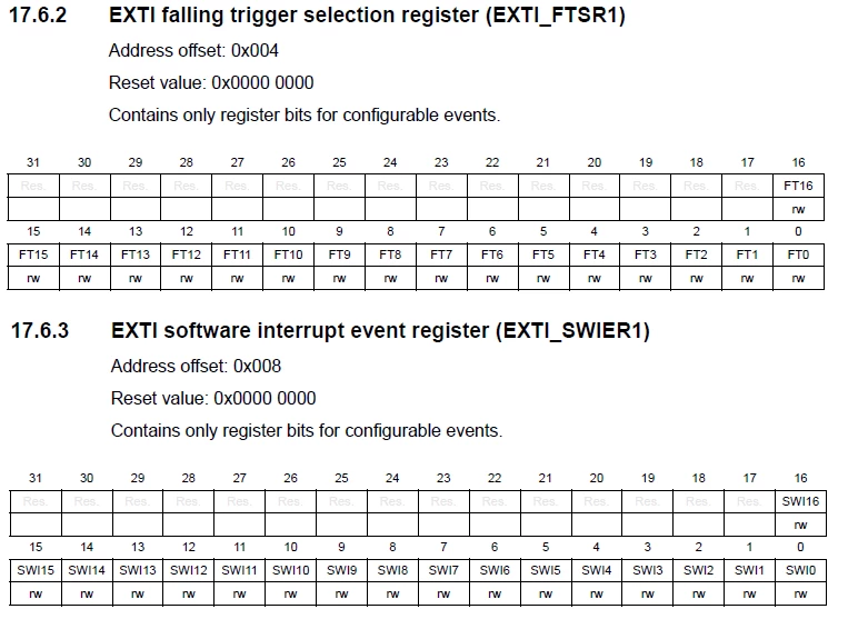

STM32H5 Comparator with EXTI_RPR1 and EXTI_FPR1 issue.
  • June 2, 2023
  • 3 replies
  • 1473 views
I get a STM32H5 Nucleo board (MB1814) and configured comparator with neccessary settings using CubeIDE and LL library and got next generated piece of code.I trigger mode choice Rising/Falling Edge Interrupt.
 LL_EXTI_EnableFallingTrig_0_31(LL_EXTI_LINE_29);
 LL_EXTI_EnableRisingTrig_0_31(LL_EXTI_LINE_29);
 LL_EXTI_ClearRisingFlag_0_31(LL_EXTI_LINE_29);
 LL_EXTI_ClearFallingFlag_0_31(LL_EXTI_LINE_29);
 LL_EXTI_DisableEvent_0_31(LL_EXTI_LINE_29);
 LL_EXTI_EnableIT_0_31(LL_EXTI_LINE_29);
 After referring to the manual, I found that there are no such register bits as mentioned.

Hello @CChen.19​ ,
It's a direct event to EXTI but we provide an errata for this and no workaround.
errata sheet : STM32H503CB/EB/KB/RB device errata - Errata sheet
"The Comparator cannot wakeup the device from low power mode (sleep/stop) when the COMP_OUT state is changed from 1 to 0 ." section 2.4 COMP ( 2.4.1)

So when I trigger a falling or rising edge interrupt, am I unable to clear the flag?
When I use COMP and enable interrupts, I am currently unable to clear the interrupt flag. Can you help me confirm if my approach is correct? I have posted a separate question with detailed steps.​

The comparator status register has a clearable interrupt flag and output status bit.
