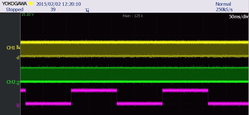

I would like to repeatedly enable/disable TIM1 CH1 and CH1x outputs. Here is my code.
static u8 step = 1;
switch(step)
case 1:
TIM_SelectOCxM(TIM1, TIM_Channel_1, TIM_OCMode_PWM1);
TIM_CCxCmd(TIM1, TIM_Channel_1, TIM_CCx_Enable);
TIM_CCxNCmd(TIM1, TIM_Channel_1, TIM_CCxN_Disable);
step = 2;
break;
case 2:
TIM_CCxCmd(TIM1, TIM_Channel_1, TIM_CCx_Disable);
TIM_CCxNCmd(TIM1, TIM_Channel_1, TIM_CCxN_Enable);
step=1;
break;
This part of code is called every 50ms. The duty cycle for CH1 is set to be 50%. What I expected to see is 50ms waveform with PWM output followed by 50ms disabled state output. However, the code didn't work as expected and both CH1 and CH1x continuously output without any disabled status. Would anyone please suggest how to realize the waveform I expected?

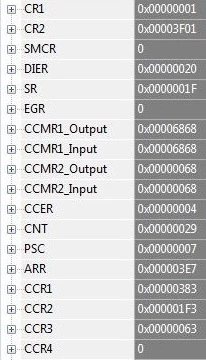

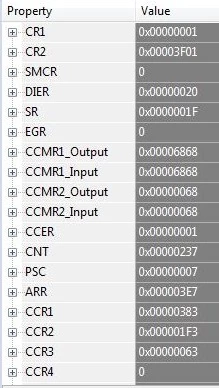

    In the following picture, channel 1 and 2 are CH1 and CH1x respectively, and channel 3 is the pulses generated by GPIO_ToggleBits(GPIOD, GPIO_Pin_12) I added before the switch command.
    I attached some pictures to show the register values, and you can see the register changed accordingly, but the output of CH1 and CH1x didn't change at all.
    before
    CCER = 0x4
    after
    CCER = 0x1;

    I asked you for *all* TIM1 registers' content. TIM1 (and TIM8) has more registers than other timers.
    > CR2 == 0x3F01
    Do you understand the implications of this, especially  the CCPC bit being set?

    Thank you so much for pointing out CCPC. I should have read the manual more carefully. Now everything works fine. Thank you very very much.
