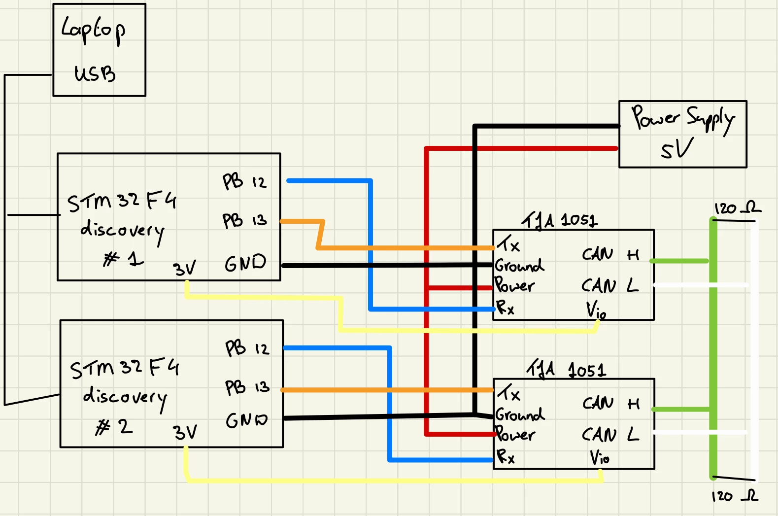

Hi there, I'm new to ST development and am currently trying to setup a CAN connection between two STM32F4 discovery board. However, using an oscilloscope I can see that no messages are being send. Can anyone help me out finding what the problem is?
Attached are my main.c and a schematic overview of all connections.

I am using CAN2, so that's why FilterBank and SlaveStartFilterBank are 15 and 14 resp. Also the filter does not filter anything, so may I ask why you think the problem lays here? Do you have any remarks on the electrical connections?
I am using STM32CubeIDE for this, so I also attached the .ioc file of the project if that helps.

If you are using the same board for the two nodes and you are not seeing anything on the bus using the oscilloscope, you have to:
- Don't use any internal clock source (HSI etc) .. to clock the CAN peripheral. Use crystal for system clock.
- Check all the connections (connection continuity check).
- Check your bitrate: it should not exceed 1Mb/s.
- Check your transceivers, they could be not genuine. Some chips on the market are fake!
- If the transceiver has a standby pin, please check its datasheet to know how to force it to wake up from this mode.

I don't do Cube/HAL, so I cannot help you with that.
First thing is, you can bypass the transceivers and connect Rx/Tx directly if the cables are not too long. Though in this case, you will need a GND connection, too.
Second, check the CAN_ESR register after transmission attempts. If the value goes up, there is probably a wiring issue.
