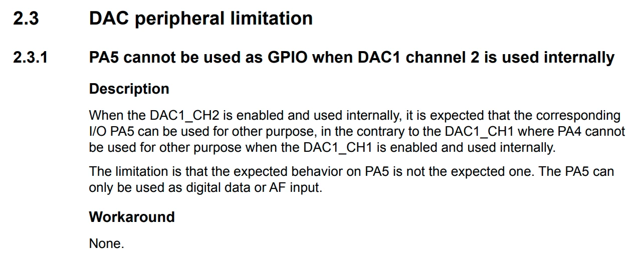

I read a lot about it for other STM32 MCUs but can't find any confirmation that it’s not possible to use PA4 and PA5 as GPIO output and DAC1 channel 1 and channel 2 internally for STM32F303CBT6. There's a hint in the errata of another STM32F303* using PA5 (ES0246 Rev 8, 2.3.1 on page 11/21) but for STM32F303CBT6 there is no limitation, yet.

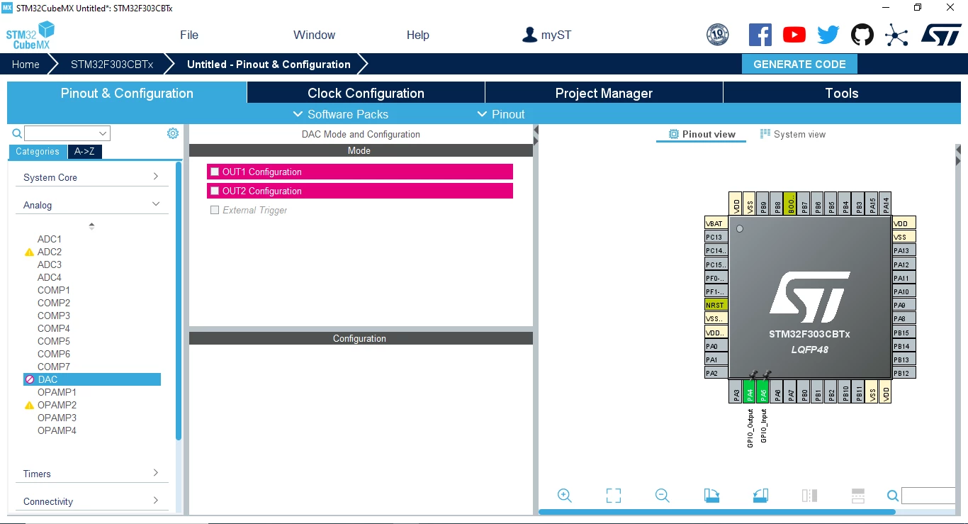

Hello @DRH
As you can see in the screenshot, you can even configure the OUT 1 in CubeMX when you use PA4  as an output or input mode or alternate function.

September 25, 2023
The (very poorly worded) errata applies to your chip, but it suggests only PA5 is affected.
"STM32F303xx silicon limitations" certainly applies to the STM32F303CBT6.

September 25, 2023
PA4 can't be used for other purpose when when the DAC1_CH1 is enabled and used internally. PA5 is affected by the errata. Then both of them can't be used.
