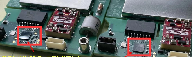

STM32F103REY6TR We bought this part at different times,Now,Different appearance phenomena are found on the surface of the chip,One has a specular sheen and one has a matte black,I wonder if both are normal phenomena?At the same time, attach a picture
  • July 5, 2022
  • 1199 views
If so, what are the reasons for the difference,If not, which phenomenon is normal? Please see picture, Thank you very much0693W00000QKTKJQA5.png0693W00000QKTIIQA5.png

Two clues: no ST logo and part number not recognized with a search on the ST web site.
If this is a clone, you may have to ask the clone manufacturer representative.

Only marking of one actually provided
The 32F103E6 / 93 marking is consistent with parts used on INEMO-M1 which was a STM32F103REY6 WLCSP.
Where it was packaged would have an impact, as would how the wafer is ground/polished for a CSP
