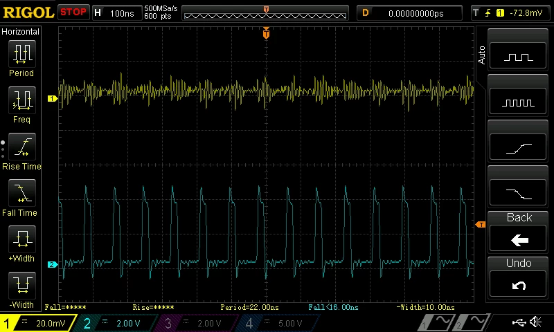

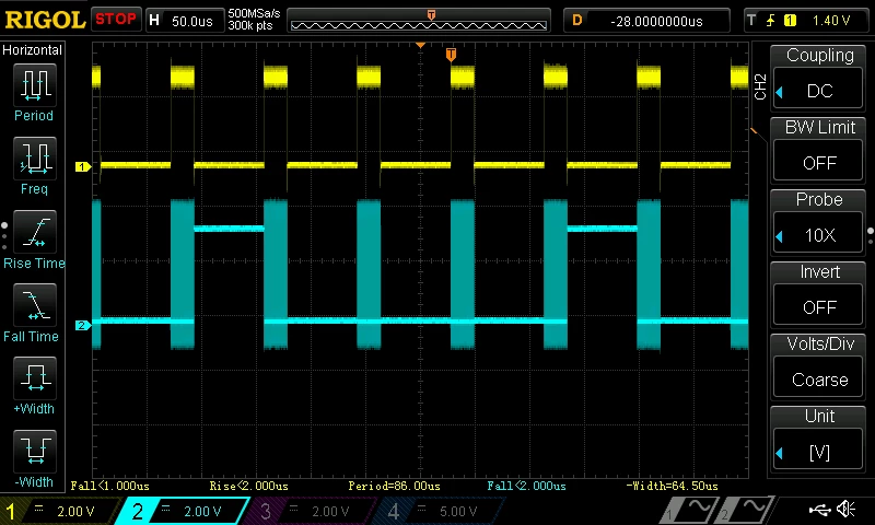

Hello everybody,
since two days I struggle with curious noises at Pin 6 (TQFP32) by STM32F051K8.
In my application I try to start TIM2 with TIM14 in kaskade mode (I have slight changed the sample code).
I attach my source and screenshots with the signals.
On the screen you can see signal of TIM14 (yellow) Pin 10 and
signal with noises of TIM2 Pin 6 (blue).
Has anyone any idea what's wrong?
Thanks in advance!

Posted on September 29, 2016 at 13:25
Hi richter.andrey,
The TIM2_CH1 is on PA0 and not on PA6. Verify that you put the measure point on the right place , and GND is connected. Fothe code it seems ok , just checkth TIM2_CH1 pin polarity and delect the CtrlOutputEnable for TIM14.
