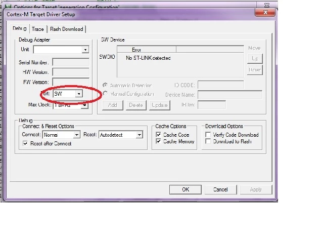

    For debugging, verify that the connection is serial. go to Options for target..->Debug->use ST-link debugger->settings->Port:SW. Also, verify the choice of the flash under flash download.
    Hope, this can help.
