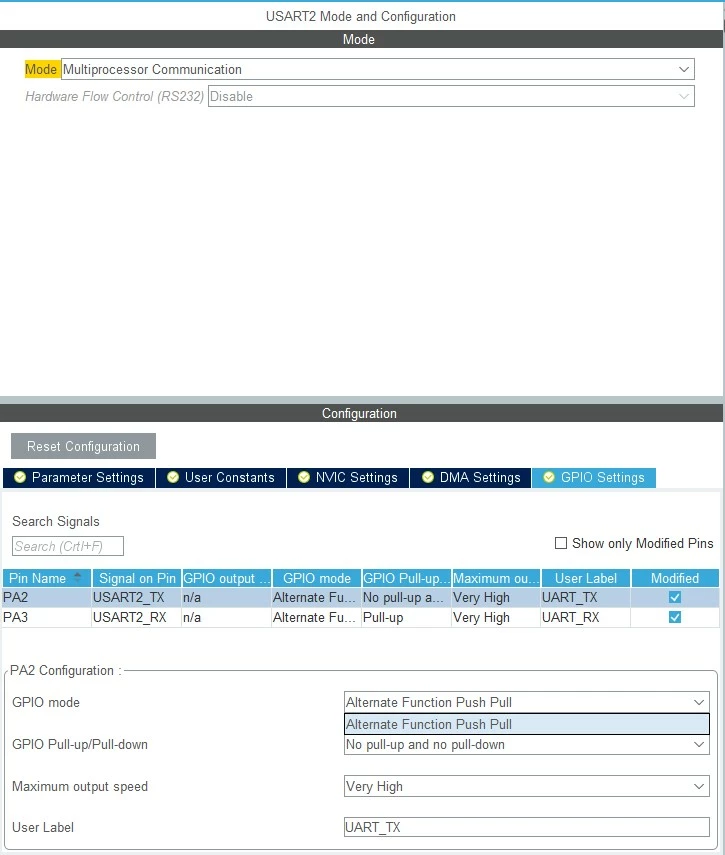

I'd like to use USART for multiprocessor communication. For this I have to configure the TX pin to an open drain mode. But this option is not available:
MCU: STM32F446ZEH6
STM32CubeMX: 5.1.0
Best regards,
Eugene

    Go beyond cubeMx and search in the source code GPIO_MODE_AF_OD
    Just hack at C HAL level .

    Thanks, I know about this. But manual changes will be lost every time when I generate code with CubeMX. Is there any other option?

    Use user code area in source to override cubemx initialization or wait for cubemx fix?

    Yes, but that will cause an unwanted voltage glitch on the pin, because it will be configured 2 times.
    Is there a way to modify any CubeMX configuration file to get this option? If not, then, would be good that this bug will be fixed in future release.
