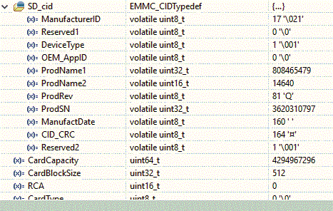

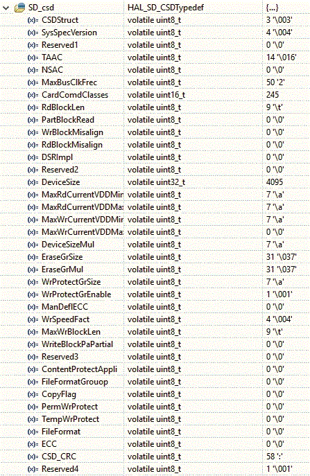

    Uros Males
    October 13, 2015
    Posted on October 13, 2015 at 14:23
    clive1, thanks for your input.
    This is the card info I get from eMMC: 0690X0000060MnMQAU.gif 0690X0000060MnNQAU.gif *block_size = SDCardInfo.CardBlockSize = 512 *block_num = SDCardInfo.CardCapacity / SDCardInfo.CardBlockSize =8388608 I think I may have a problem with descriptor:
