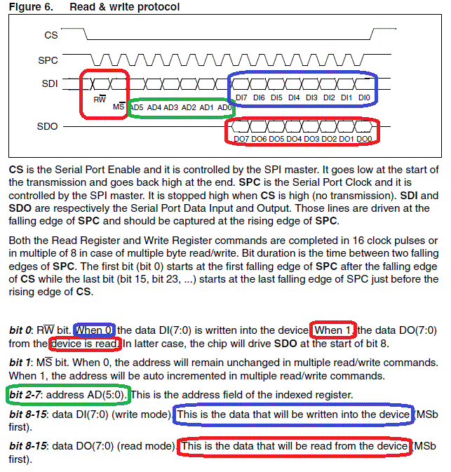

i am trying to figure out how to get stm32f4 discovery board accelerometer work. After checking the lisd302dl datasheet and reference manual (that wasn't too much helpful) ,i went to forum where i find the example in this
/public/STe2ecommunities/mcu/Lists/STM32Discovery/Flat.aspx?RootFolder=https://my.st.com/public/STe2ecommunities/mcu/Lists/STM32Discovery/STM32F4%20Discovery%20Accelerometer%20SPI%20Problem&FolderCTID=0x01200200770978C69A1141439FE559EB459D75800084C20D8867EAD444A5987D47BE638E0F&currentviews=2921
. Could somebody explain to us (obviously i am not the only one who asked about that) why and where did we find the adress to send on the spi (
0xAB00,
0x20C7)
? I am asking since i didn t find anything in both previous references. Thank you for your attention

    I guess you could look at the bit waveforms described in the
    http://www.st.com/web/en/resource/technical/document/datasheet/CD00135460.pdf
    , and review the register bit settings.

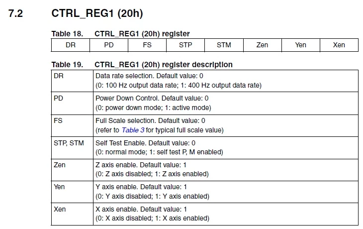

    0x20C7 - Write value 0xC7 into register 0x20 (CTRL_REG1)
    0xAB00 - Read value from register 0x2B (OUT_Y)
    0x00 (WRITE) + 0x20 (CTRL_REG1) = 0x20
    0x80 (READ) + 0x2B (OUT_Y) = 0xAB
    The high order byte is the Command, and Read/Write direction, the low order byte is the value to Write if sending data to a register.

    I still don t get it neither can find it : why do we need to write 0xc7 in CTRL_REG1?
    Is also 0x80 +register adress a normalisation for receiving data in spi?

    0xC7 because I guess you want the device powered up, output high-rate measurements, and want the X, Y & Z channels enabled?
