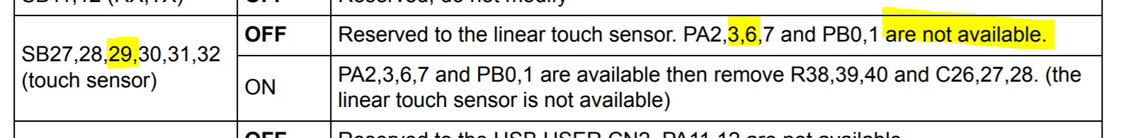

SPI not working with MISO connected to 3V and 0V
I am trying to code SPI functionality to connect with an external 16-bit ADC. The STM32 only receives data from the ADC, so only a MISO and SCLK line, along with a Conversion/CS line is required. I am currently using the 32F072BDISCOVERY board to test my code. Unfortunately, I do not have access to the ADC yet, so to perform simple testing to see if my SPI code is working, I figured I could set the MISO line to ground to receive all 0s or to 3V to receive all 1s. However, no matter what I connect the MISO line to, I only receive 1s.
To make things simple, I set the SPI peripheral data size on the STM32 to 8 bits.
Here is my code. Super simple so I don't know what could be going wrong here.
uint8_t spi_value[1];
HAL_SPI_Receive(&hspi1, spi_value,1,1000);
I am reading out the value over UART and checking it in the live variables section in the debugger. It always is 255, which is the equivalent of all 1s.

PA6 is not available at the pin header by default as it's connected to the linear touch sensor. It requires some reconfiguration to expose it at the pin interface.
The user manual has a good amount of information on this and other things:
https://www.st.com/resource/en/user_manual/dm00099401-discovery-kit-for-stm32f0-series-microcontrollers-with-stm32f072rb-stmicroelectronics.pdf

The "not working" pin is PA6. I'm not entirely sure what else it's wired up to. If it is wired to something else that's preventing me from using it, why would they break out that pin to a header on the board in the first place?
JAlle.2
JAlle.2Author
Dec 31, 2020 7:15 PM UTC
Ah well that'll do it. Pretty frustrating how hidden that detail seems to be. I feel like something like that be made more visible and clear in the user manual. I mean now it makes sense that its located in the solder bridge section and I'll know to look there from now on, but for someone new to embedded programming like me, if I was looking to use SPI on the dev board, I would intuitively look for a section on SPI or PA6 pin, not the solder bridge section and linear touch sensor. There's a whole section on the pins and their functions, why not make some kind of comment there or have some kind of asterisk to bring your attention to it! I did scan the document a couple times before but you can't even find it if you use ctrl-F to search for 'PA6' because of the comma and other pins they use between PA and 6.
