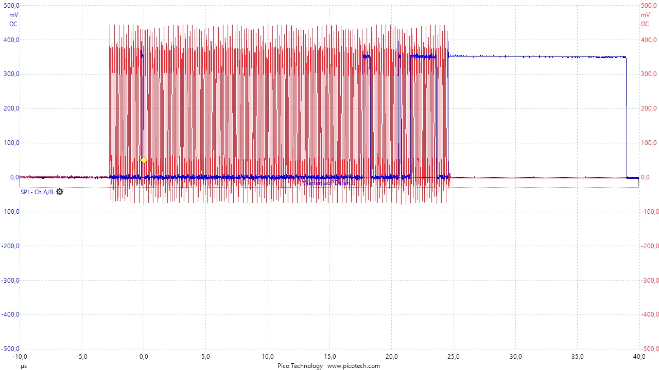

yes, you are absolutely right! I have tried several things in the meantime, but it seems that the slave puts in the right data into the buffer, but I see very different signals on the MISO wire. That's kind of strange! But maybe I'm doing something wrong in general: where do I have to call the HAL_SPI_TransmitReceive_DMA function in the slave? I currently do this, when I get the external interrupt from the CS line. Is this correct?
Thanks and best regards
Christoph
KR51K
KR51KAuthor

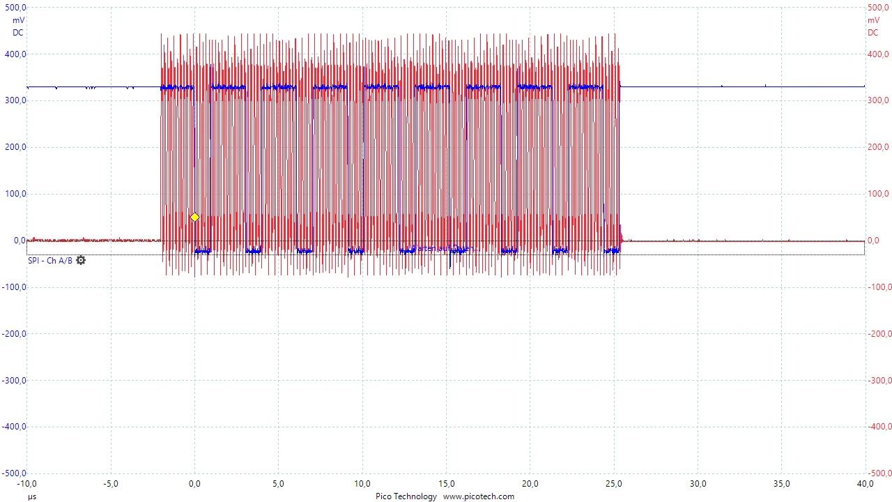

May 9, 2020
Ok, another thing I noticed: if I watch the MISO signal with the scope, everything is ok. But when I pause the debugger, I see this 'strange' data pattern on the MISO line. So what I could imagine is that the slave has an error with the HAL_SPI_TransmitReceive_DMA function at one point during the runtime and does not recover. So, anyone an idea what the correct behaviour is, if you get a a status != HAL_NOK from HAL_SPI_TransmitReceive_DMA?
KR51K
KR51KAuthor
May 9, 2020
Normal behaviour
Behaviour during debugger paused:
waclawek.jan
May 9, 2020
We still know nothing about your application.
If slave receives clocks and there is nothing which would write to the SPI transmit register (e.g. because the program which normally writes to it is stopped by debugger), it keeps repeatedly transmitting the last frame.
