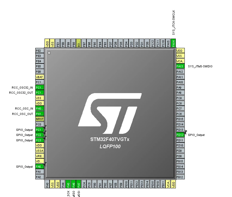

I want to do SPI communication between STM32F407VG board and Eval-STPM34 metrology board , i am trying to read just a register of the Eval-STPM34 but i always fail , i used these pins to ensure the SPI communication :
STM32 -----> EVAL-STPM34
MOSI-----> MOSI
MISO-----> MISO
SCL -----> SCL
PC1 -----> SCS
PC2 -----> SYN
PC3 -----> EN
PA0 -----> LED2
GND -----> GND
VCC -----> VCC

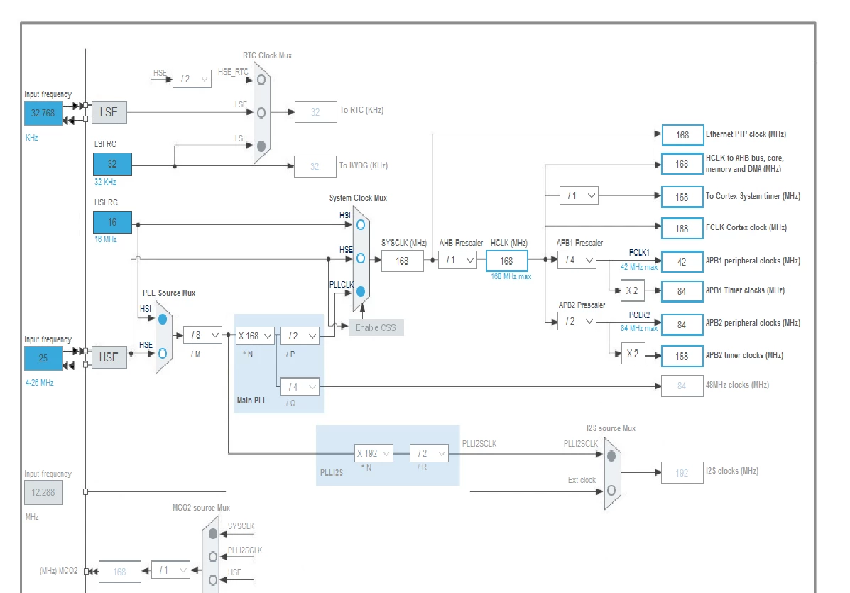

And i made the CubeMX configuration below ....

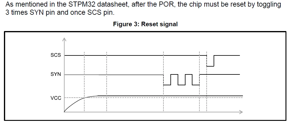

2-i found also that i must initialize SYN
"As mentioned in the STPM34 datasheet, after the POR, the chip must be reset by toggling
3 times SYN pin and once SCS pin."
and you find the sequence of reset below ......
So i edited this code :
HAL_GPIO_WritePin(GPIOC,GPIO_PIN_1,GPIO_PIN_SET); //SET SCS
HAL_GPIO_WritePin(GPIOC,GPIO_PIN_2,GPIO_PIN_SET); //SET SYN
 for(uint8_t i=0;i<=2; i++)
HAL_GPIO_WritePin(GPIOC,GPIO_PIN_2,GPIO_PIN_RESET); //Reset SYN
DWT_Delay_us(100);
  HAL_GPIO_WritePin(GPIOC,GPIO_PIN_2,GPIO_PIN_SET); //Set SYN
DWT_Delay_us(100);
HAL_GPIO_WritePin(GPIOC,GPIO_PIN_1,GPIO_PIN_RESET); //Reset SCS
DWT_Delay_us(100);
HAL_GPIO_WritePin(GPIOC,GPIO_PIN_1,GPIO_PIN_SET); // SET SCS

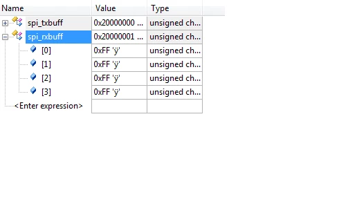

3-And finally i want to read the register row 2 which it default value is 0x000004E0 , it address is 0x04 as mentionned in the datasheet of STPM34 so i edited this code :
spi_txbuff[0]=0x04; //buffer contains adress of the register
HAL_GPIO_WritePin(GPIOC,GPIO_PIN_1,GPIO_PIN_RESET); //RESET SCS
HAL_SPI_Transmit(&hspi1,spi_txbuff,1,50); //Send register adress
HAL_SPI_Receive(&hspi1,spi_rxbuff,4,50); //Read register data (4 bytes)
And unfortunately in debugging mode i always find : 0xFF 0xFF 0xFF 0xFF
