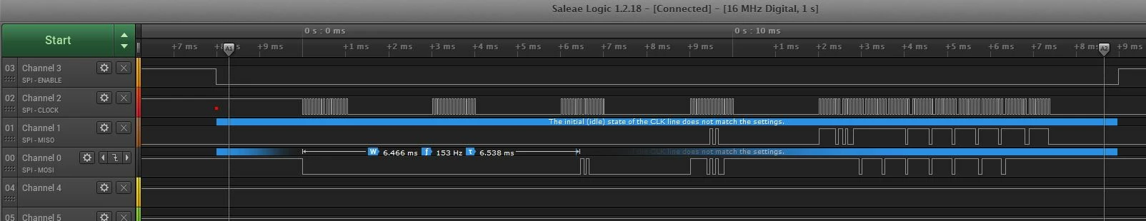

RoofG
Visitor II
July 24, 2018
I am having the same problem getting my spi to work. Required is CPOL=0 (Clock low when inactive) and CPHA=1 ( get data on trailing clock). The initial clock level is high and only goes to the required low once the first package is sent. Slave is active low.

and then i send by using this:
HAL_StatusTypeDef spi_status = HAL_SPI_TransmitReceive(&hspi1,0b000000000000, 0b000000000000, sizeof(uint16_t),0xffff);
This is what the communication looks like, the clock line is initially high which in my opinion should be low. After and between the transmissions the clock line goes low as expected.
